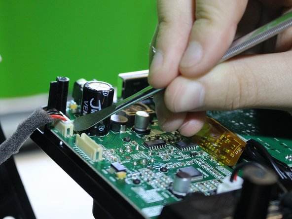

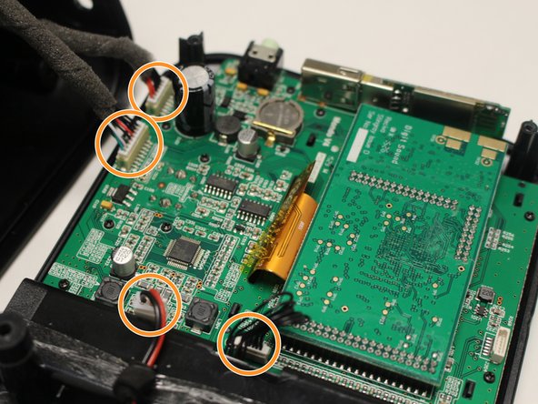

      • Detach a pin connector at the top of the device using a metal spudger to open up the inner components.
      • Detach (4) pin connectors inside using a metal spudger to separate the front panel from the rest of the device.
