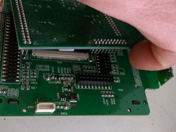

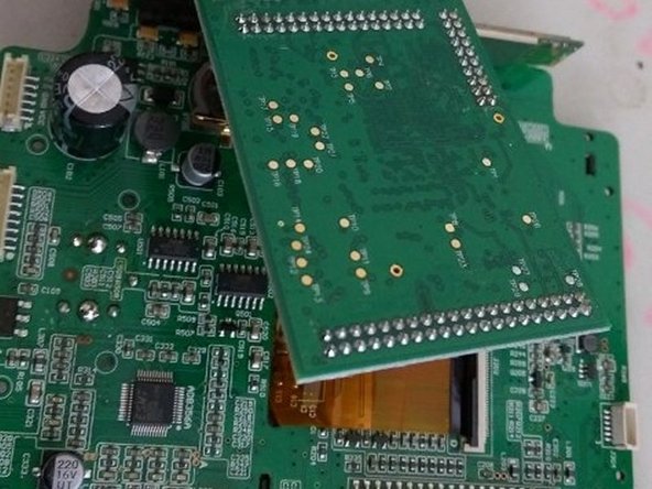

  9. Grace Digital Mondo LCD Replacement & Part #s, Remove Daughter (Audio?) Board: crwdns2935265:09crwdnd2935265:01crwdnd2935265:03crwdne2935265:0 Grace Digital Mondo LCD Replacement & Part #s, Remove Daughter (Audio?) Board: crwdns2935265:09crwdnd2935265:02crwdnd2935265:03crwdne2935265:0 Grace Digital Mondo LCD Replacement & Part #s, Remove Daughter (Audio?) Board: crwdns2935265:09crwdnd2935265:03crwdnd2935265:03crwdne2935265:0
    • At this point, you can see the motherboard with the daughter board (Audio Controller?) and the LCD Cable running under it.
    • Gently pull upward on the daughter board to remove it from the motherboard and access the LCD cable. Be careful not to bend any pins.

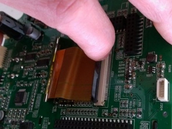

  10. Grace Digital Mondo LCD Replacement & Part #s, Disconnect LCD Cable: crwdns2935265:010crwdnd2935265:01crwdnd2935265:02crwdne2935265:0 Grace Digital Mondo LCD Replacement & Part #s, Disconnect LCD Cable: crwdns2935265:010crwdnd2935265:02crwdnd2935265:02crwdne2935265:0
    • Carefully lift the black tab on the LCD Connector to release the LCD Cable.
    • There are 4 black clips holding the LCD Display to the other side of the mother board. Gently release the clips by pressing down on each one, so they pop through the other side.
    • Thread the LCD Cable outward, through the slot on the motherboard.

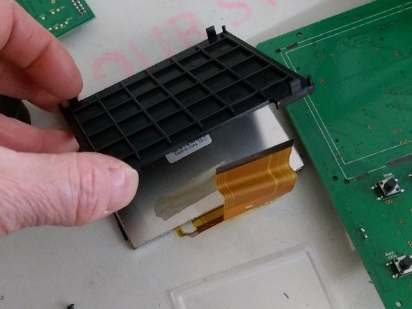

  11. Grace Digital Mondo LCD Replacement & Part #s, Remove Display Housing: crwdns2935265:011crwdnd2935265:01crwdnd2935265:02crwdne2935265:0 Grace Digital Mondo LCD Replacement & Part #s, Remove Display Housing: crwdns2935265:011crwdnd2935265:02crwdnd2935265:02crwdne2935265:0
    • You now have the LCD Panel, but it is still in a protective casing, which must be removed to replace the LCD.
    • The LCD Panel is attached with a little adhesive. Simply use gentle pressure at the bottom of the LCD, near the cable, to push it out of the casing.

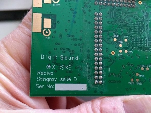

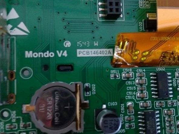

  12. Grace Digital Mondo LCD Replacement & Part #s, Part Numbers: crwdns2935265:012crwdnd2935265:01crwdnd2935265:03crwdne2935265:0 Grace Digital Mondo LCD Replacement & Part #s, Part Numbers: crwdns2935265:012crwdnd2935265:02crwdnd2935265:03crwdne2935265:0 Grace Digital Mondo LCD Replacement & Part #s, Part Numbers: crwdns2935265:012crwdnd2935265:03crwdnd2935265:03crwdne2935265:0
    • That's it! Now for the part numbers.
    • First we have the LCD Panel #LQ035NC111
    • Next the Motherboard part number is Mondo V4 PCB146402A
    • Next, the daughter board (Audio Controller?) which only says: Digit Sound Reciva Stingray Issue D

    • Best of luck! I went through these steps due to a Display Issue. The radio has audio, but I cannot see anything on the screen. I don't know, for certain, whether the LCD Display is faulty or the controller (motherboard). Any feedback would be appreciated.

Update: I wanted to let people know that I was shipped a Motherboard from the company when I called them about the issue. Replacing the motherboard (not the Display panel) resolved my 'no display' issue.
