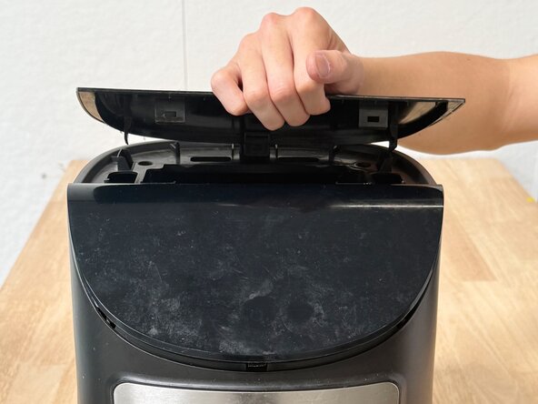

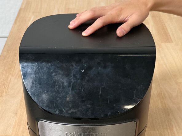

    • Carefully pry the control panel unit off of the air fryer, starting above where the “Gourmia” logo is positioned.
  3. Gourmia GAF798 Control Panel Replacement: crwdns2935265:03crwdnd2935265:01crwdnd2935265:03crwdne2935265:0 Gourmia GAF798 Control Panel Replacement: crwdns2935265:03crwdnd2935265:02crwdnd2935265:03crwdne2935265:0 Gourmia GAF798 Control Panel Replacement: crwdns2935265:03crwdnd2935265:03crwdnd2935265:03crwdne2935265:0

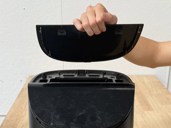

    • Pry open the control panel unit as much as possible without damaging the part.
    • Detach the back lid from the air fryer.

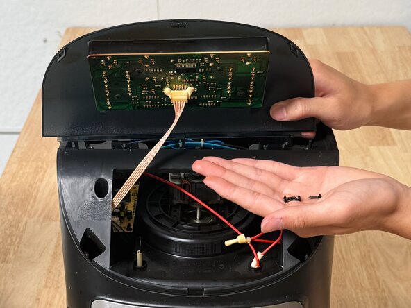

  4. Gourmia GAF798 Control Panel Replacement: crwdns2935265:04crwdnd2935265:01crwdnd2935265:02crwdne2935265:0 Gourmia GAF798 Control Panel Replacement: crwdns2935265:04crwdnd2935265:02crwdnd2935265:02crwdne2935265:0
    • Use a Phillips #0 screwdriver to remove the three screws holding on the control panel unit.
    • Pull up the control panel unit to expose the circuit board.

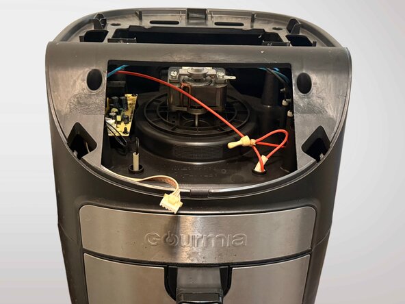

  5. Gourmia GAF798 Control Panel Replacement: crwdns2935265:05crwdnd2935265:01crwdnd2935265:02crwdne2935265:0 Gourmia GAF798 Control Panel Replacement: crwdns2935265:05crwdnd2935265:02crwdnd2935265:02crwdne2935265:0
    • Unplug the cable that connects from the air fryer’s motherboard to the original control panel circuit board by gently pinching the side tabs of the cable's end.
  6. Gourmia GAF798 Control Panel Replacement: crwdns2935265:06crwdnd2935265:01crwdnd2935265:01crwdne2935265:0
    • Plug the cable that connects from the air fryer’s motherboard into the new control panel circuit board.
