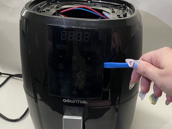

    • Use blue opening tool to pry open one side of grey top
    • If there is a loud pop, it is not broken.
  2. Gourmia GAF536 Screen Circuit Board Replacement: crwdns2935265:02crwdnd2935265:01crwdnd2935265:01crwdne2935265:0
    • Pry open all four sides.
  3. Gourmia GAF536 Screen Circuit Board Replacement: crwdns2935265:03crwdnd2935265:01crwdnd2935265:01crwdne2935265:0
    • Remove grey top.

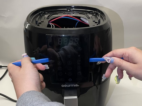

    • Locate the internal tabs that hold the screen in place. (There should be 2 tabs on top, 2 tabs on the bottom, and 1 on each side.)
    • Focus on the side tabs.
  5. Gourmia GAF536 Screen Circuit Board Replacement: crwdns2935265:05crwdnd2935265:01crwdnd2935265:03crwdne2935265:0 Gourmia GAF536 Screen Circuit Board Replacement: crwdns2935265:05crwdnd2935265:02crwdnd2935265:03crwdne2935265:0 Gourmia GAF536 Screen Circuit Board Replacement: crwdns2935265:05crwdnd2935265:03crwdnd2935265:03crwdne2935265:0
    • Using your finger or the metal sludger, release the tab on the side.
    • Gently push the open side forward and place the blue opener into the gap from the front.
    • Repeat this on the other side.
  6. Gourmia GAF536 Screen Circuit Board Replacement: crwdns2935265:06crwdnd2935265:01crwdnd2935265:02crwdne2935265:0 Gourmia GAF536 Screen Circuit Board Replacement: crwdns2935265:06crwdnd2935265:02crwdnd2935265:02crwdne2935265:0
    • Once both sides of the screen have a blue opener, the screen can be safely popped out.

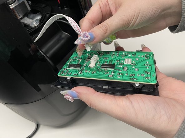

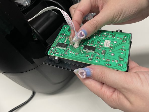

    • Remove the cable connecting the circuit board to the air-fryer’s motherboard by gently pinching the tab on the side connected to the screen.
  8. Gourmia GAF536 Screen Circuit Board Replacement: crwdns2935265:08crwdnd2935265:01crwdnd2935265:02crwdne2935265:0 Gourmia GAF536 Screen Circuit Board Replacement: crwdns2935265:08crwdnd2935265:02crwdnd2935265:02crwdne2935265:0

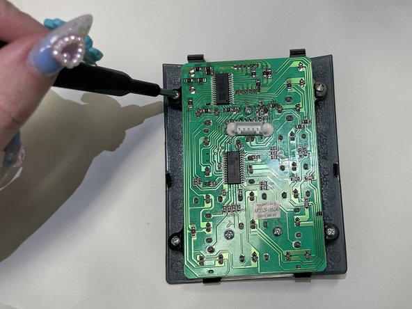

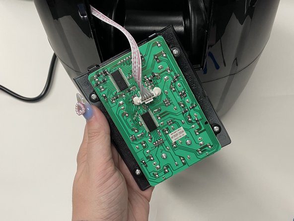

    • Remove all of the screws that attach the circuit board to the display screen and casing.
    • 7x PH 02 Screws: 5mm x 10 mm.
  9. Gourmia GAF536 Screen Circuit Board Replacement: crwdns2935265:09crwdnd2935265:01crwdnd2935265:01crwdne2935265:0
    • The circuit board can now be detached from the display screen, removed from the plastic casing, and replaced.
