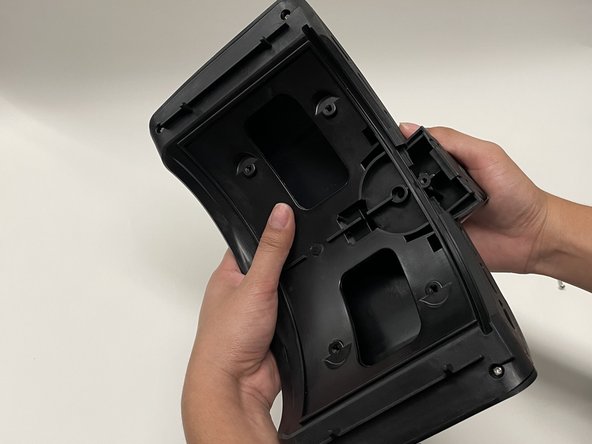

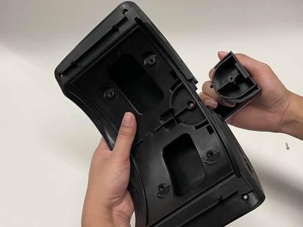

    • Once the screws are removed separate the handle from the basket.

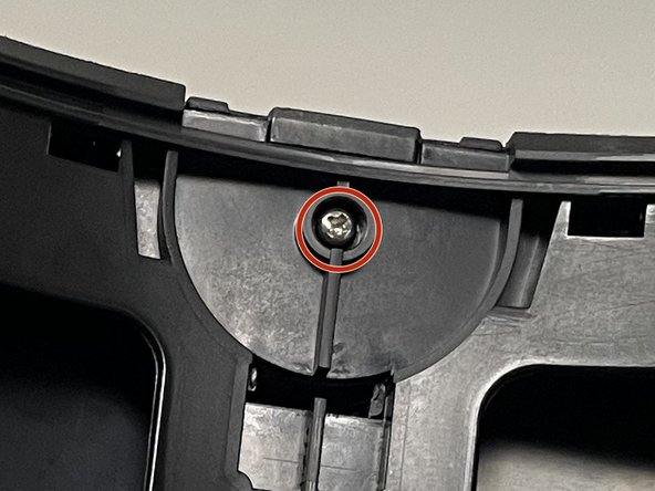

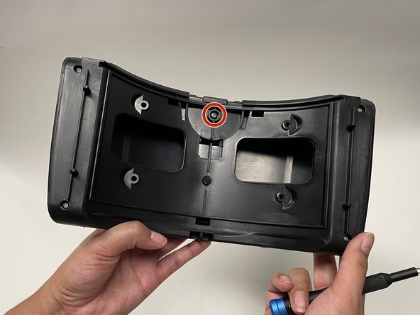

    • Locate the single screw on the handle.
    • 1x PH02 Screw: 15mm x 5mm
  4. Gourmia GAF536 Handle Replacement: crwdns2935265:04crwdnd2935265:01crwdnd2935265:03crwdne2935265:0 Gourmia GAF536 Handle Replacement: crwdns2935265:04crwdnd2935265:02crwdnd2935265:03crwdne2935265:0 Gourmia GAF536 Handle Replacement: crwdns2935265:04crwdnd2935265:03crwdnd2935265:03crwdne2935265:0
    • Remove the screw.
    • Gently pull on the handle with the force needed.
