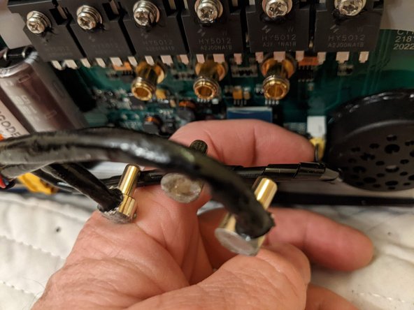

  3. Gotway Begode Mten4 Electric Unicycle Controler Board Replacement, Unplug the motor: crwdns2935265:03crwdnd2935265:01crwdnd2935265:02crwdne2935265:0 Gotway Begode Mten4 Electric Unicycle Controler Board Replacement, Unplug the motor: crwdns2935265:03crwdnd2935265:02crwdnd2935265:02crwdne2935265:0
    • Do not unplug a wire or wires by pulling on the wire. The wire is built to electrical not mechanical standards. If a connector won't wiggle apart using your fingers, then use a tool to grip the connector by the shell.
    • Unplug the three motor wires from the board.
    • Unplug the Hall Effect sensor harness from the board.

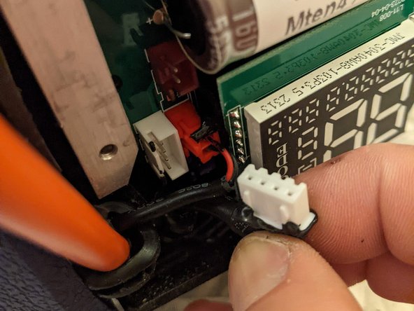

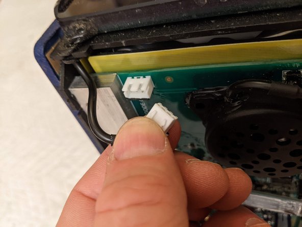

  4. Gotway Begode Mten4 Electric Unicycle Controler Board Replacement, Disconnect remaining harnesses: crwdns2935265:04crwdnd2935265:01crwdnd2935265:03crwdne2935265:0 Gotway Begode Mten4 Electric Unicycle Controler Board Replacement, Disconnect remaining harnesses: crwdns2935265:04crwdnd2935265:02crwdnd2935265:03crwdne2935265:0 Gotway Begode Mten4 Electric Unicycle Controler Board Replacement, Disconnect remaining harnesses: crwdns2935265:04crwdnd2935265:03crwdnd2935265:03crwdne2935265:0
    • These connectors pull apart with no snap retention. Observe the connectors are "staked" with RTV or silicone adhesive to prevent disconnection when you're riding and you hit a bump. During reassembly, reapply a dab of easily removable staking.
    • Disconnect the power connector for the controller board.
    • Disconnect the tail light connector from the controller board
    • Disconnect the headlight from the controller board
