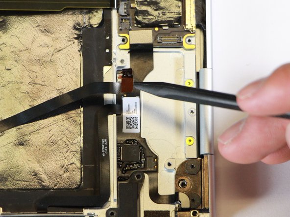

    1. Google Pixelbook Sound Card Replacement, Sound Card: crwdns2935265:014crwdnd2935265:01crwdnd2935265:01crwdne2935265:0
      • Use the spudger to disconnect the sound card from the motherboard by pulling the connector up and away from the motherboard.
    2. Google Pixelbook Sound Card Replacement: crwdns2935265:015crwdnd2935265:01crwdnd2935265:02crwdne2935265:0 Google Pixelbook Sound Card Replacement: crwdns2935265:015crwdnd2935265:02crwdnd2935265:02crwdne2935265:0
      • Flip open the connection point on the sound card by using the spudger to pop the latch upward.
      • Disconnect the black ribbon cable from the sound card by using the spudger or your fingers to pull the cable out and away from the connecting port.

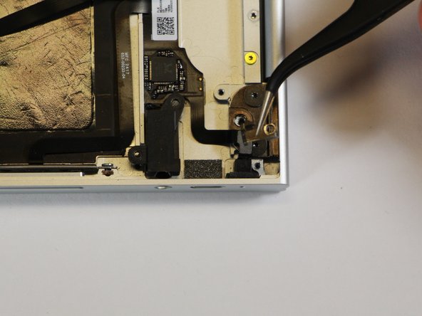

    3. Google Pixelbook Sound Card Replacement: crwdns2935265:016crwdnd2935265:01crwdnd2935265:02crwdne2935265:0 Google Pixelbook Sound Card Replacement: crwdns2935265:016crwdnd2935265:02crwdnd2935265:02crwdne2935265:0
      • Use the needle-nose tweezers to remove the silver casing by lifting it up and out of the laptop.

    5. Google Pixelbook Sound Card Replacement: crwdns2935265:018crwdnd2935265:01crwdnd2935265:01crwdne2935265:0
      • Use a T3 Torx screwdriver to remove the two silver 3.0mm screws located on the vertical edge of the casing by turning the screws counterclockwise.

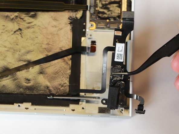

    6. Google Pixelbook Sound Card Replacement: crwdns2935265:019crwdnd2935265:01crwdnd2935265:02crwdne2935265:0 Google Pixelbook Sound Card Replacement: crwdns2935265:019crwdnd2935265:02crwdnd2935265:02crwdne2935265:0
      • Use the needle-nose tweezers to remove the sound card by lifting it up and out of the laptop.
