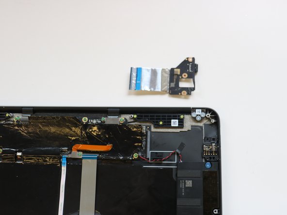

  5. Google Pixelbook Go Right Charging Port Replacement, Right Charging Port: crwdns2935265:05crwdnd2935265:01crwdnd2935265:01crwdne2935265:0
    • Remove the three pink screws from the right charging port using a T3 Torx screwdriver.
  6. Google Pixelbook Go Right Charging Port Replacement: crwdns2935265:06crwdnd2935265:01crwdnd2935265:02crwdne2935265:0 Google Pixelbook Go Right Charging Port Replacement: crwdns2935265:06crwdnd2935265:02crwdnd2935265:02crwdne2935265:0
    • Remove the right charging port by picking it up and lifting it from the computer.
