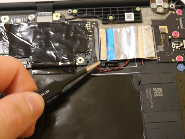

  7. Google Pixelbook Go Motherboard Replacement: crwdns2935265:07crwdnd2935265:01crwdnd2935265:03crwdne2935265:0 Google Pixelbook Go Motherboard Replacement: crwdns2935265:07crwdnd2935265:02crwdnd2935265:03crwdne2935265:0 Google Pixelbook Go Motherboard Replacement: crwdns2935265:07crwdnd2935265:03crwdnd2935265:03crwdne2935265:0

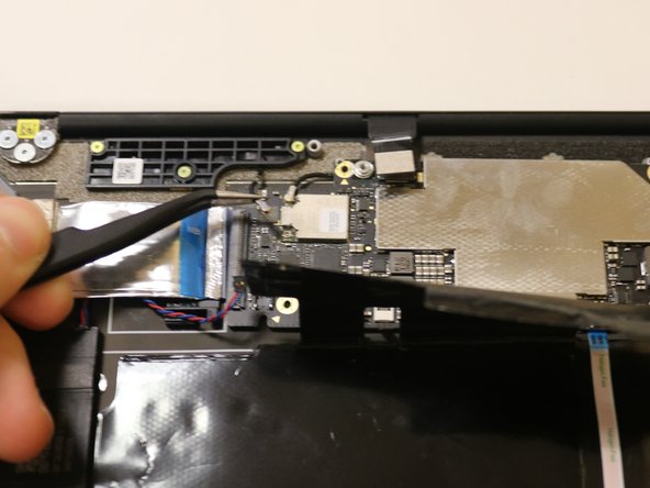

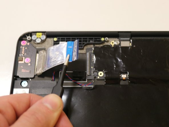

    • Disconnect the blue and red wiring cable using the needle nose tweezers. Grab as close to the connection as you can, and tug in an upwards motion.
    • Do this to both sides.

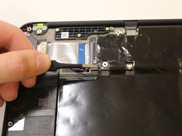

  8. Google Pixelbook Go Motherboard Replacement: crwdns2935265:08crwdnd2935265:01crwdnd2935265:03crwdne2935265:0 Google Pixelbook Go Motherboard Replacement: crwdns2935265:08crwdnd2935265:02crwdnd2935265:03crwdne2935265:0 Google Pixelbook Go Motherboard Replacement: crwdns2935265:08crwdnd2935265:03crwdnd2935265:03crwdne2935265:0

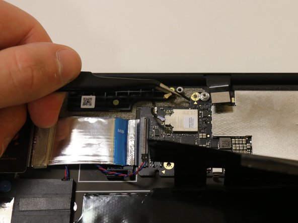

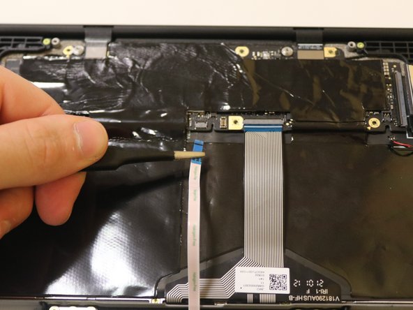

    • Detach the left-hand side, wide ribbon by pulling away from the connection itself. Grab as close as you can to the connection using your spudger.
    • This part may require additional force, but be mindful not to snap it.

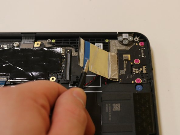

  9. Google Pixelbook Go Motherboard Replacement: crwdns2935265:09crwdnd2935265:01crwdnd2935265:02crwdne2935265:0 Google Pixelbook Go Motherboard Replacement: crwdns2935265:09crwdnd2935265:02crwdnd2935265:02crwdne2935265:0
    • Similarly, detach the right-hand side, flat ribbon by pulling away from the connection.

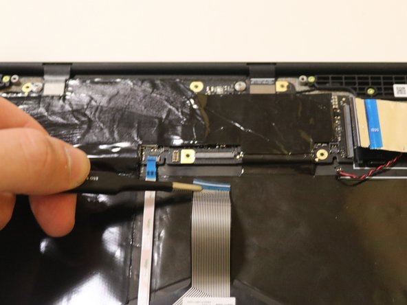

  10. Google Pixelbook Go Motherboard Replacement: crwdns2935265:010crwdnd2935265:01crwdnd2935265:02crwdne2935265:0 Google Pixelbook Go Motherboard Replacement: crwdns2935265:010crwdnd2935265:02crwdnd2935265:02crwdne2935265:0

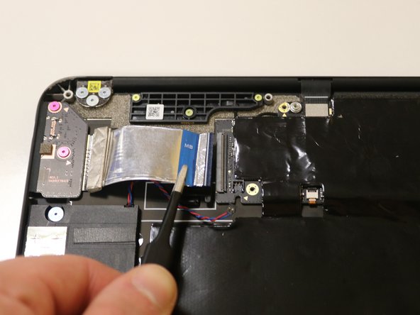

    • Detach the thin, flat cable in the middle using your spudger or by gently pulling with your hand near the connection itself.
  11. Google Pixelbook Go Motherboard Replacement: crwdns2935265:011crwdnd2935265:01crwdnd2935265:02crwdne2935265:0 Google Pixelbook Go Motherboard Replacement: crwdns2935265:011crwdnd2935265:02crwdnd2935265:02crwdne2935265:0
    • Detach the wider, middle cable using the same steps as before. Pull away from the connection, grabbing as close to the connection as you can.
  12. Google Pixelbook Go Motherboard Replacement: crwdns2935265:012crwdnd2935265:01crwdnd2935265:02crwdne2935265:0 Google Pixelbook Go Motherboard Replacement: crwdns2935265:012crwdnd2935265:02crwdnd2935265:02crwdne2935265:0
    • Detach the small, copper colored cable from the motherboard. Since this cable is so small, it will require needle-nose tweezers.

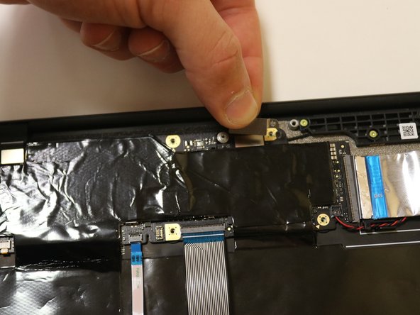

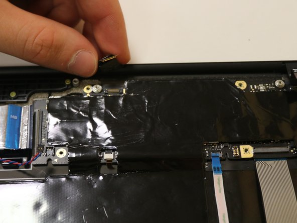

    • By hand, disconnect the top two clips gently. Although you want to detach these clips from the motherboard, these clips will remain attached on the reverse end to the base.
  14. Google Pixelbook Go Motherboard Replacement: crwdns2935265:014crwdnd2935265:01crwdnd2935265:03crwdne2935265:0 Google Pixelbook Go Motherboard Replacement: crwdns2935265:014crwdnd2935265:02crwdnd2935265:03crwdne2935265:0 Google Pixelbook Go Motherboard Replacement: crwdns2935265:014crwdnd2935265:03crwdnd2935265:03crwdne2935265:0
    • Gently peel back the adhesive plastic covering towards the main body.
    • Avoid ripping the plastic covering as this is easy to do.

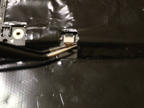

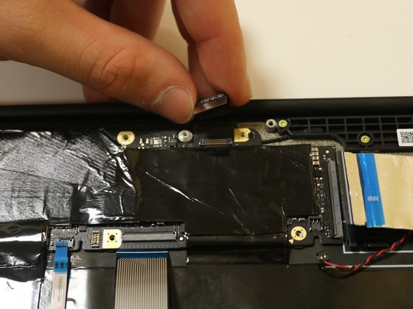

  15. Google Pixelbook Go Motherboard Replacement: crwdns2935265:015crwdnd2935265:01crwdnd2935265:03crwdne2935265:0 Google Pixelbook Go Motherboard Replacement: crwdns2935265:015crwdnd2935265:02crwdnd2935265:03crwdne2935265:0 Google Pixelbook Go Motherboard Replacement: crwdns2935265:015crwdnd2935265:03crwdnd2935265:03crwdne2935265:0
    • Detach the final two clips attached to the motherboard using the needle nose tweezers, located at the top left of the motherboard.

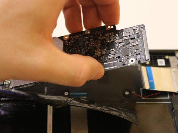

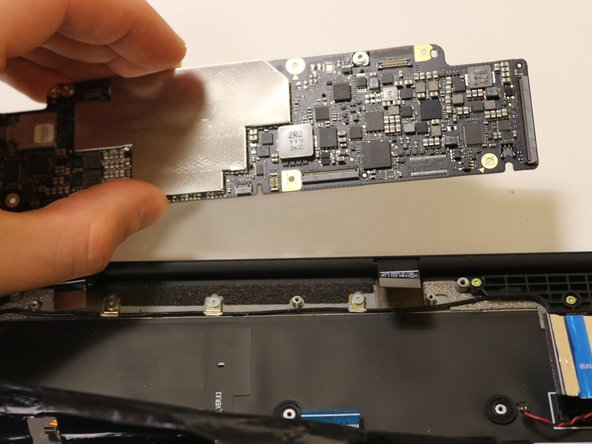

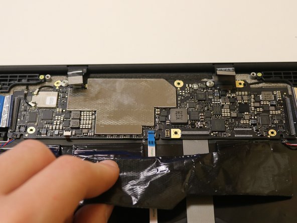

  16. Google Pixelbook Go Motherboard Replacement: crwdns2935265:016crwdnd2935265:01crwdnd2935265:03crwdne2935265:0 Google Pixelbook Go Motherboard Replacement: crwdns2935265:016crwdnd2935265:02crwdnd2935265:03crwdne2935265:0 Google Pixelbook Go Motherboard Replacement: crwdns2935265:016crwdnd2935265:03crwdnd2935265:03crwdne2935265:0
    • Remove the motherboard by gently lifting with your hands.
