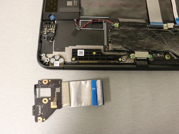

  5. Google Pixelbook Go Left Charging Port Replacement, Left Charging Port: crwdns2935265:05crwdnd2935265:01crwdnd2935265:01crwdne2935265:0
    • Find the left side of the device by locating the white stickers
    • Remove the three pink screws using a T3 Torx screwdriver.
  6. Google Pixelbook Go Left Charging Port Replacement: crwdns2935265:06crwdnd2935265:01crwdnd2935265:02crwdne2935265:0 Google Pixelbook Go Left Charging Port Replacement: crwdns2935265:06crwdnd2935265:02crwdnd2935265:02crwdne2935265:0
    • Carefully grab the silver tab and slide the left charging port out of the laptop.
