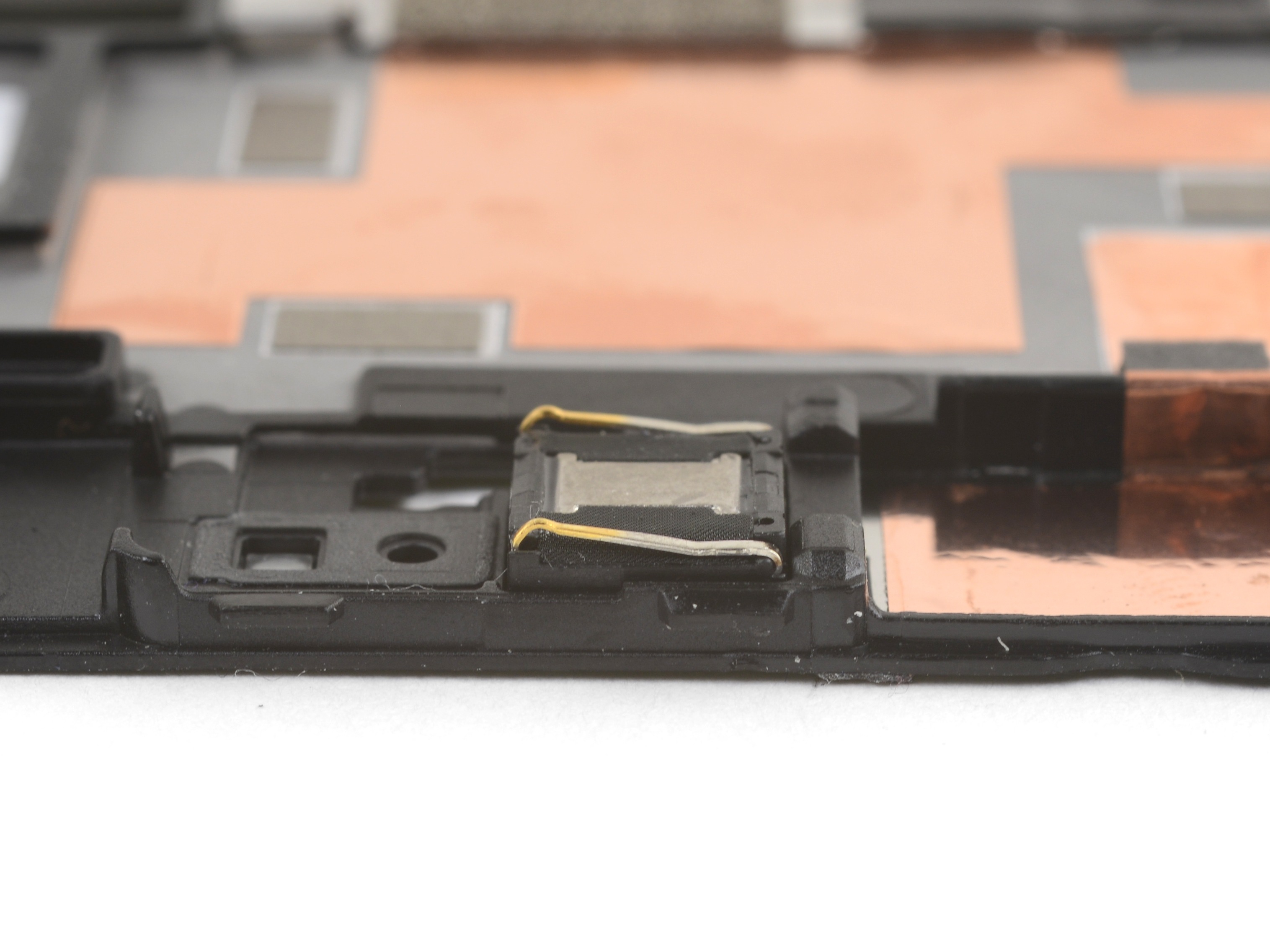

  17. Google Pixel XL Earpiece Speaker Replacement, Earpiece Speaker: crwdns2935265:017crwdnd2935265:01crwdnd2935265:03crwdne2935265:0 Google Pixel XL Earpiece Speaker Replacement, Earpiece Speaker: crwdns2935265:017crwdnd2935265:02crwdnd2935265:03crwdne2935265:0 Google Pixel XL Earpiece Speaker Replacement, Earpiece Speaker: crwdns2935265:017crwdnd2935265:03crwdnd2935265:03crwdne2935265:0
    • Flip the midframe over.
    • Use the point of a spudger to pry up and loosen the earpiece speaker from the plastic midframe.
    • Remove the earpiece speaker.
    • During reassembly, be sure install the replacement part in the proper orientation. The gold colored clips should face towards the camera hole.
