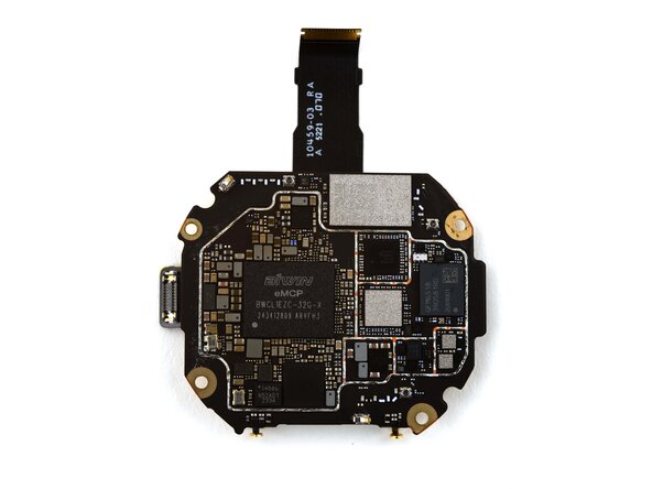

    1. Google Pixel Watch 4 Chip ID, Main Board - Front Side: crwdns2935265:01crwdnd2935265:01crwdnd2935265:02crwdne2935265:0 Google Pixel Watch 4 Chip ID, Main Board - Front Side: crwdns2935265:01crwdnd2935265:02crwdnd2935265:02crwdne2935265:0
      • Qualcomm SW5100 Snapdragon W5+ Gen 2 quad-core applications processor layered under a Biwin BWCL1EZC-32G-X 2 GB LPDDR4X & 32 GB NAND flash
      • Ambiq AP510NFA-CCR ARM Cortex-M55 microcontroller
      • Cirrus Logic CS40L26 haptic driver
      • Qorvo ACT28020 battery charger
      • Qualcomm envelope tracker
      • Richtek AMOLED display power supply

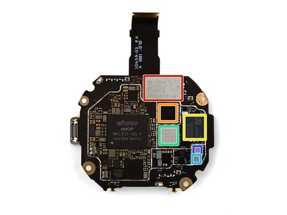

    2. Google Pixel Watch 4 Chip ID, Main Board - Front Side - Connectivity: crwdns2935265:02crwdnd2935265:01crwdnd2935265:01crwdne2935265:0
      • Likely USI WP1-2023-GS1 Bluetooth & WiFi module
      • Qualcomm WTR3925 RF transceiver
      • Qualcomm QFM6518 front-end module
      • Qualcomm QPA6590 RF power amplifier
      • Skyworks SKY65725-11 GPS/GNSS/BDS LNA front-end module
      • Skyworks SKY65728-11 GPS LNA front-end module

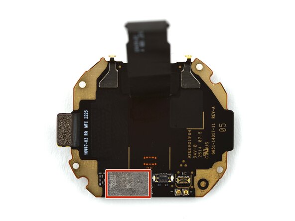

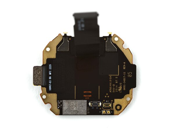

    4. Google Pixel Watch 4 Chip ID, Main Board - Back Side - Connectivity: crwdns2935265:04crwdnd2935265:01crwdnd2935265:02crwdne2935265:0 Google Pixel Watch 4 Chip ID, Main Board - Back Side - Connectivity: crwdns2935265:04crwdnd2935265:02crwdnd2935265:02crwdne2935265:0
      • Likely USI WP1-2023-GN1 NFC module
