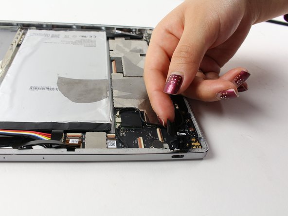

    1. Google Pixel C Power Button Replacement, Power Button: crwdns2935265:05crwdnd2935265:01crwdnd2935265:01crwdne2935265:0
      • Locate the power button along the edge of the tablet.
      • The actual power button technology is the black plastic piece located directly inside the device behind the silver button; this is what will be replaced.

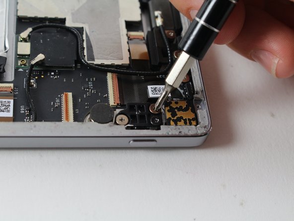

      • Locate and remove the black 4.3mm Phillips #000 screw.
      • Remove the remaining two silver 4.2mm Phillips #000 screws.

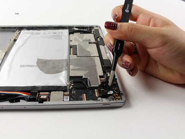

      • Use tweezers to slowly pull up on the power button technology as far as possible without pulling out the two black wires attached.
      • Don't pull up too hard, as the wires could be ripped out and damaged.

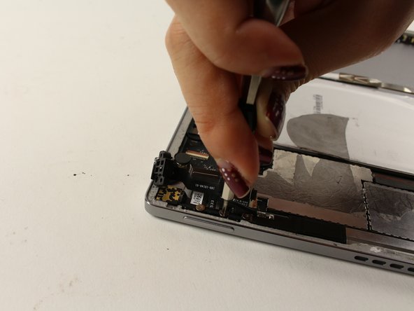

      • Detach the larger connector wire by flipping the copper hinge located at the base of the connection with your fingernail.
    5. Google Pixel C Power Button Replacement: crwdns2935265:09crwdnd2935265:01crwdnd2935265:01crwdne2935265:0
      • Flip the hinge of the second, more narrow wire to release the connection.

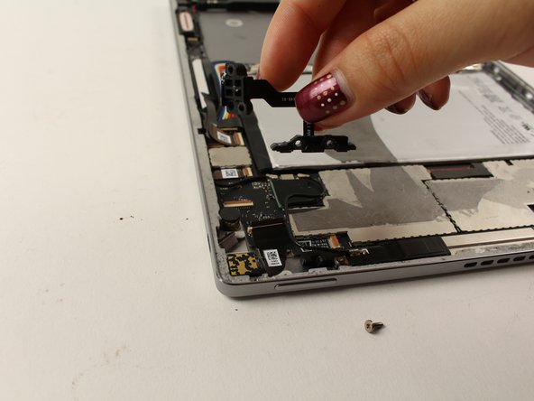

      • Once all the screws are removed, gently pull up on the entire power button technology piece, to remove it from the device.
To reassemble your device, follow these instructions in reverse order. New adhesive will be needed to re-apply the screen.
