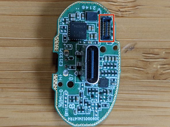

    • This case had an issue that caused the buds to stay connected, even after being inserted into the case. However, if the case was plugged in, everything worked as expected. So, this lead me to try swapping the mainboard with another unit.
    • Once the case is open, carefully slide the halves apart. There is a thin ribbon cable connecting the parts.
    • At the bottom is a thin plastic separator on top of the main board applied with a small amount of adhesive. You should be able to easily pull it up out of the way.
    • Underneath, you'll find the main board held in place by two screws. One is highlighted in the picture, the second is above it to the right.
    • Remove the two screws, then to remove the board use a toothpick to push on the USB connector from the bottom. This will make it easier to dislodge the board, allowing you to remove it from the bottom
  3. Google Pixel Buds A-Series Mainboard Replacement, Disconnecting the ribbon cable: crwdns2935265:03crwdnd2935265:01crwdnd2935265:03crwdne2935265:0 Google Pixel Buds A-Series Mainboard Replacement, Disconnecting the ribbon cable: crwdns2935265:03crwdnd2935265:02crwdnd2935265:03crwdne2935265:0 Google Pixel Buds A-Series Mainboard Replacement, Disconnecting the ribbon cable: crwdns2935265:03crwdnd2935265:03crwdnd2935265:03crwdne2935265:0
    • To replace the board, you'll need to disconnect the ribbon cable.
    • Use a plastic pry tool to carefully release the connector from the board. It just presses vertically straight down on the board, so lift it straight off.

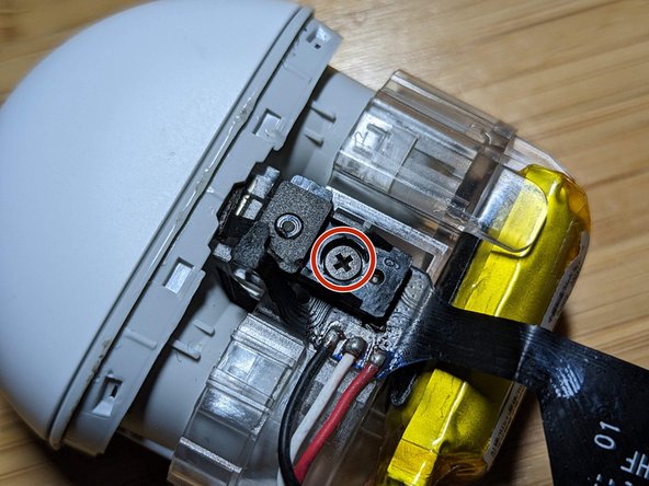

    • If you're interested in taking apart the top half, I've added some more steps. Otherwise, just replace your main board and put it back together.
    • On my second case, it had an issue preventing it from detecting if the top was opened or closed, presumably causing the battery to drain because it never went to sleep.
    • To get at the top section, remove the two screws on either side of the battery.
    • Next remove the screw holding cover for the LED and remove the cover. This step is probably optional.

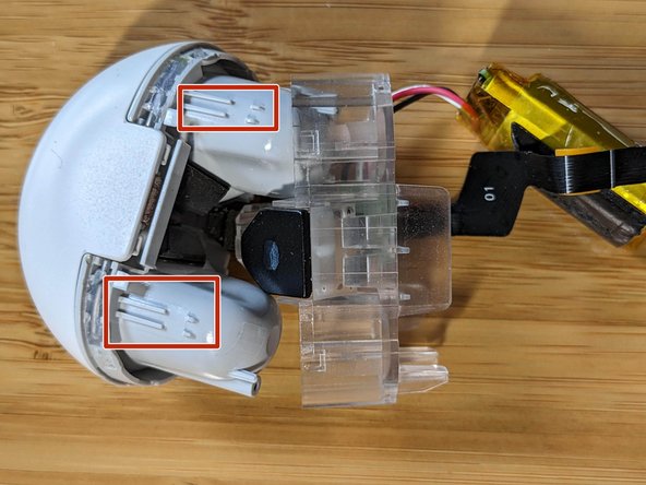

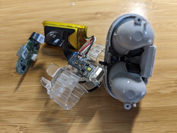

    • There are four "tabs", two on each side that need to be released to separate the clear plastic section from the rest of the top.
    • Insert a spudger or small flathead screwdriver into each tab to release it, working your way around. The two parts should separate.

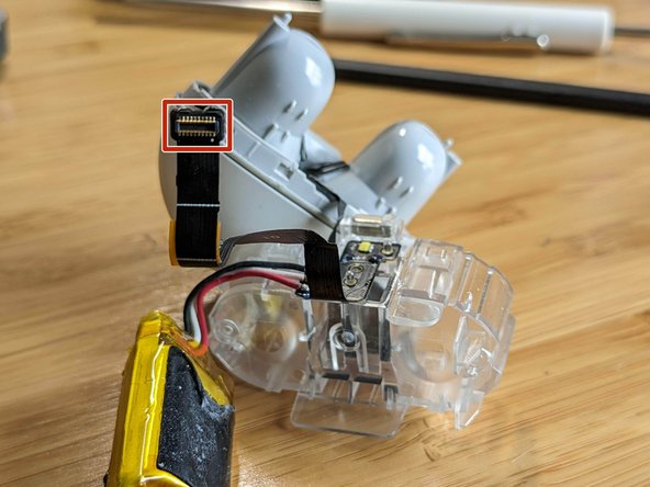

    • Now you can get at the ribbon cable that connects up to the contact pins for the ear buds.
    • In the picture I think the item shown in the marker is the magnetic sensor that detects if the case is open or closed. Since it is embedded into the ribbon cable, I did not see any easy way to replace it. In order to do so, you'd need to replace the entire ribbon cable and possibly the contact pins as well.
