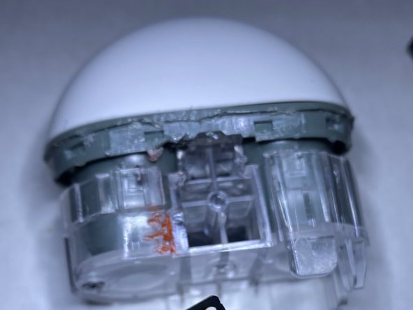

    • I took a more destructive approach to splitting the case along the seam, but applying heat to the seam and then a small amount of Isopropyl Alcohol should loosen it enough that you only have to deal with a few plastic clips.
    • The initial tool insertion can be done with a metal pry tool, but once there is a gap opened I strongly recommend switching over to a hard plastic pick to avoid causing the level of damage I did on this disassembly.
    • The ideal entry point for a metal pry tool on this main seam is towards the rear next to the main hinge. There is less or possibly no adhesive applied here, it is relatively far away from any plastic clips that are close together (increasing the risk of cracking/deforming the plastic housing), and it's the least visible part of the seam.
    • When prying along the front of the device where the LED Indicator is located be very cautious. The flex cable that connects to the power pins inside the top-half of the case can be damaged very easily. Additionally, the LED itself could potentially be damaged although that would be less likely as it is solidly anchored.

    • If you have any damage to the plastic clips on either the top or bottom half of the housing I suggest just cutting or grinding them down so that they don't catch on anything when you're reassembling the housing. I typically use a surgical scalpel and a dremel for this kind of reshaping. Scalpel is better because it does not heat the plastic.
    • We can't use tape to seal the seam again because it will bunch up and not form an even bond which means that an adhesive like E6000 or anything similar is probably going to be our best bet. Run an even bead around the seam, applying it to the top-half of the housing and making sure that you're not obscuring the LED Indicator.
    • Once your adhesive is applied, press the two halves of the housing back together being mindful of the battery wiring and all flex cables near the seam. A clamp positioned with one side on the top of the housing and the other covering the USB-C Port and/or a rubber band should be applied while the adhesive sets.

    • In my case there was quite a bit of damage to the housing that was not only visible, but also would allow things like sand and pocket lint into the device internals.
    • To address this, I mixed up a small amount of modeling epoxy and filled in those spots after the seam adhesive had set fully. Then I took a medium grit piece of sandpaper and smoothed out the surface of the epoxy. Finally I used a very high grit piece of sandpaper to blend the plastic surface in with the filler epoxy.
    • This strategy didn't result in a perfect finish (this picture is a stock photo used purely as a reference) but I am confident that on a technical level it has been restored to the same level of protection for internal components.
