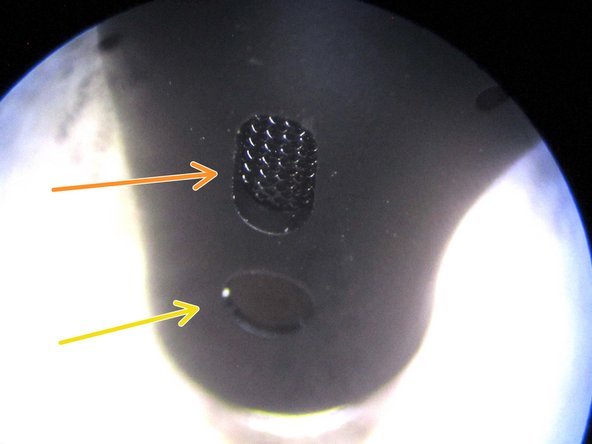

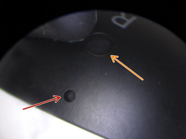

    • Back View of the Buds
    • Spatial Vent
    • Connectors for Charging the Battery when in the carrier / charging case
    • IR Detector for detecting when the buds are in the charging case or in the ear
    • IR Detector for detecting when the bud is in the ear
    • Grounded Metal Grid sound chamber cover
    • Closeup view of the Grounded Metal Grid
  5. Google Pixel Buds 2 Teardown: crwdns2935265:05crwdnd2935265:01crwdnd2935265:03crwdne2935265:0 Google Pixel Buds 2 Teardown: crwdns2935265:05crwdnd2935265:02crwdnd2935265:03crwdne2935265:0 Google Pixel Buds 2 Teardown: crwdns2935265:05crwdnd2935265:03crwdnd2935265:03crwdne2935265:0
    • Microphone port. One on each side, and opposite one another.
    • Spatial vent / grounded mesh
    • IR Detector for in ear detection

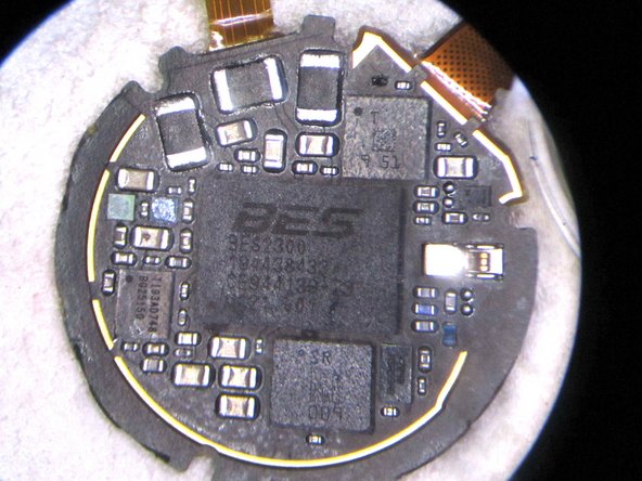

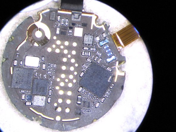

    • Closeup view of the top side of the Main PCB

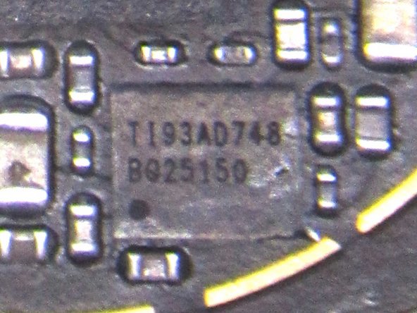

    • TI - BQ25150 - Battery Charge and Power Management
    • BES Technic - BES 2300 - Bluetooth Radio

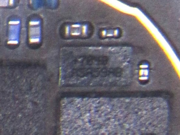

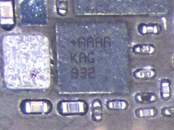

    • Unknown Device - +7048/A5A59AB - May be the Accelerometer and Gyroscope used for voice detection. Please leave a comment if you know this device

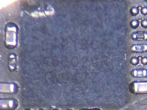

    • Unknown Device - T 9 51 - Could be Flash Memory or RAM. Please leave a comment if you know this device
    • Unknown Device - SR 009 - Could be Flash Memory or RAM. Please leave a comment if you know this deviceNew line.
