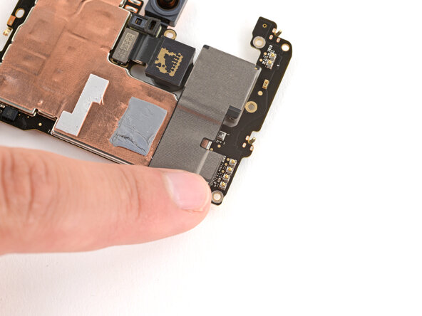

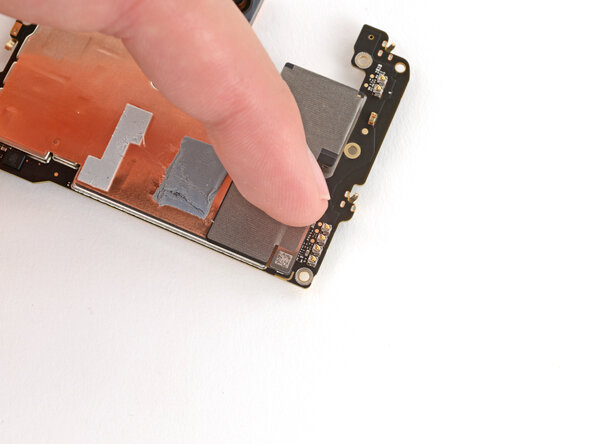

  1. Google Pixel 9a Wide Camera Installation, Install the wide camera: crwdns2935265:01crwdnd2935265:01crwdnd2935265:03crwdne2935265:0 Google Pixel 9a Wide Camera Installation, Install the wide camera: crwdns2935265:01crwdnd2935265:02crwdnd2935265:03crwdne2935265:0 Google Pixel 9a Wide Camera Installation, Install the wide camera: crwdns2935265:01crwdnd2935265:03crwdnd2935265:03crwdne2935265:0
    • Leave any lens caps or liners on the camera for now—they'll protect the lens during reassembly. You'll remove them before installing the back cover.
    • Put the wide camera into place on the logic board, being careful not to smudge the lens.
    • Align the press connector over its socket and press down with your fingertip—first on one of the short sides, then the other—until it clicks into place.
