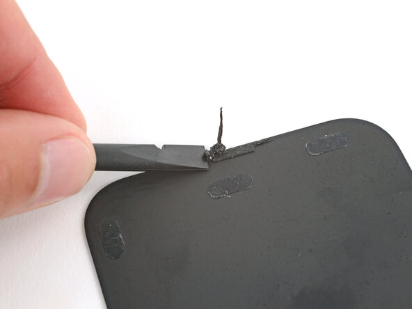

  1. Google Pixel 9a Rear Cover Inner Adhesive Application, Remove the old rear cover adhesive: crwdns2935265:01crwdnd2935265:01crwdnd2935265:02crwdne2935265:0 Google Pixel 9a Rear Cover Inner Adhesive Application, Remove the old rear cover adhesive: crwdns2935265:01crwdnd2935265:02crwdnd2935265:02crwdne2935265:0
    • Use the flat end of a spudger to scrape up and remove any all the old adhesive that stayed on the back cover, including the five pieces of small, oval‑shaped adhesive.
    • If you don't see all the oval adhesives, some might've stuck to the phone frame.

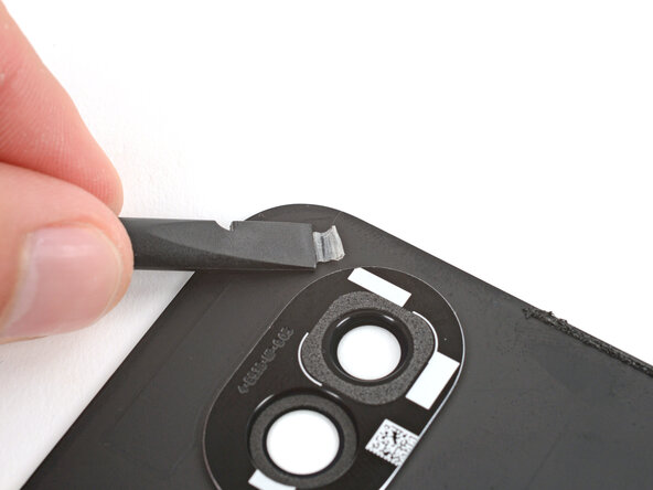

  2. Google Pixel 9a Rear Cover Inner Adhesive Application: crwdns2935265:02crwdnd2935265:01crwdnd2935265:01crwdne2935265:0
    • Use high‑concentration (>90%) isopropyl alcohol and a lint‑free cloth (or coffee filter) to clean up and remove any residue from the adhesives you removed.

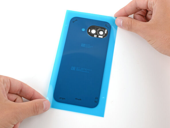

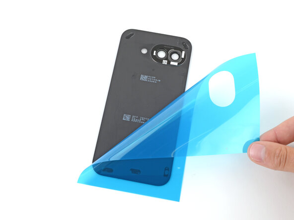

  3. Google Pixel 9a Rear Cover Inner Adhesive Application, Apply the adhesive: crwdns2935265:03crwdnd2935265:01crwdnd2935265:02crwdne2935265:0 Google Pixel 9a Rear Cover Inner Adhesive Application, Apply the adhesive: crwdns2935265:03crwdnd2935265:02crwdnd2935265:02crwdne2935265:0
    • Remove the larger, clear liner from the back cover inner adhesive.
    • Lay the adhesive onto the bottom of the back cover, making sure the cutout goes around the camera bezel.
  4. Google Pixel 9a Rear Cover Inner Adhesive Application, Secure the adhesive: crwdns2935265:04crwdnd2935265:01crwdnd2935265:02crwdne2935265:0 Google Pixel 9a Rear Cover Inner Adhesive Application, Secure the adhesive: crwdns2935265:04crwdnd2935265:02crwdnd2935265:02crwdne2935265:0
    • Use your fingers or a spudger to firmly push down on the five small adhesives to secure them to the back cover.
    • Slowly peel up and remove the remaining liner.
    • If the adhesives start to peel up with the liner, lay it back down and use your spudger to secure the adhesive again.
