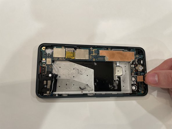

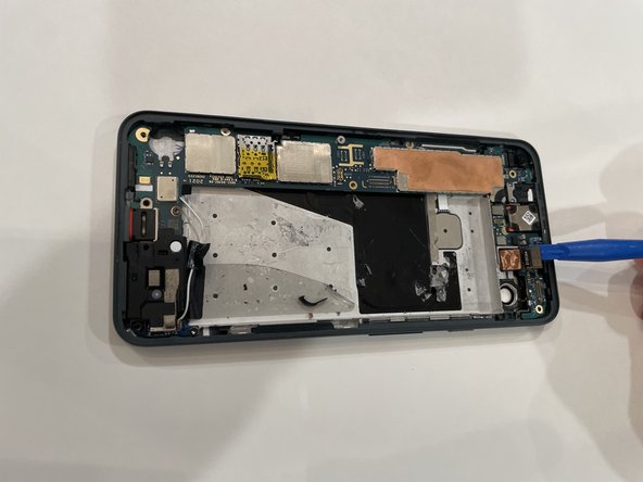

  11. Google Pixel 5a Rear-Facing Cameras  Replacement, Rear-Facing Cameras: crwdns2935265:011crwdnd2935265:01crwdnd2935265:02crwdne2935265:0 Google Pixel 5a Rear-Facing Cameras  Replacement, Rear-Facing Cameras: crwdns2935265:011crwdnd2935265:02crwdnd2935265:02crwdne2935265:0
    • Place an opening tool under the camera connector and pry upward.
    • Carefully remove the camera connector from the phone.

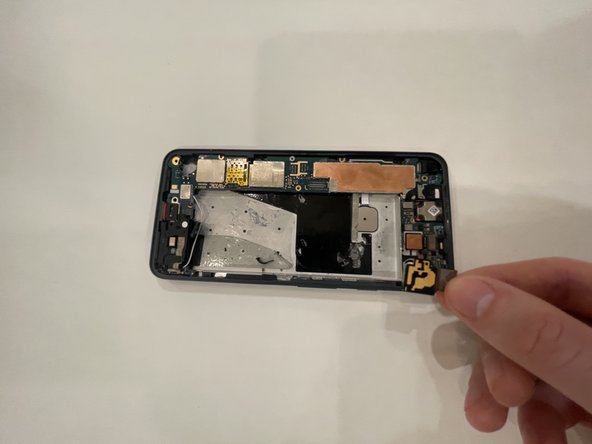

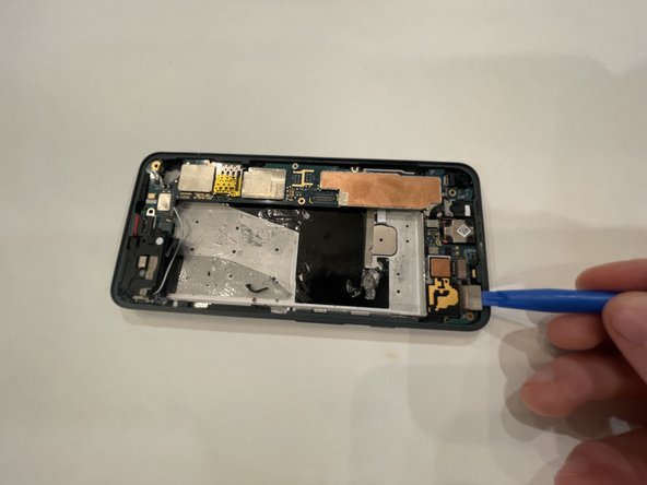

  12. Google Pixel 5a Rear-Facing Cameras  Replacement: crwdns2935265:012crwdnd2935265:01crwdnd2935265:02crwdne2935265:0 Google Pixel 5a Rear-Facing Cameras  Replacement: crwdns2935265:012crwdnd2935265:02crwdnd2935265:02crwdne2935265:0
    • Place an opening tool under the camera and pry upward.
    • Carefully remove the camera from the phone.
