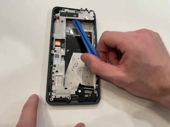

    • Pry the screen off of your device using an opening tool around all four sides.

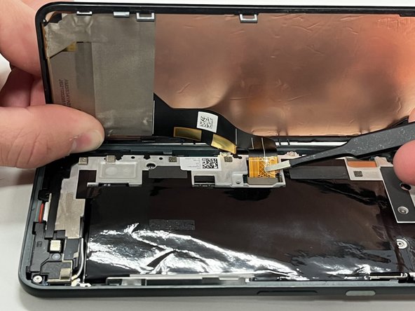

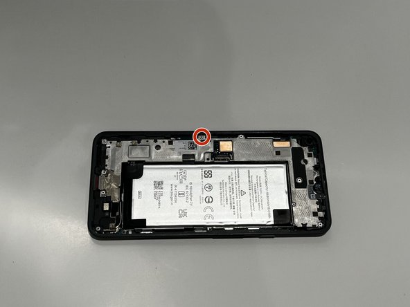

    • Remove the 4 mm screw using a T4 Torx screwdriver.
    • Disconnect the ribbon cable holding the screen in place.
    • Remove the screen from the rest of the phone.

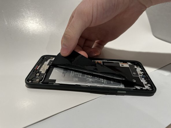

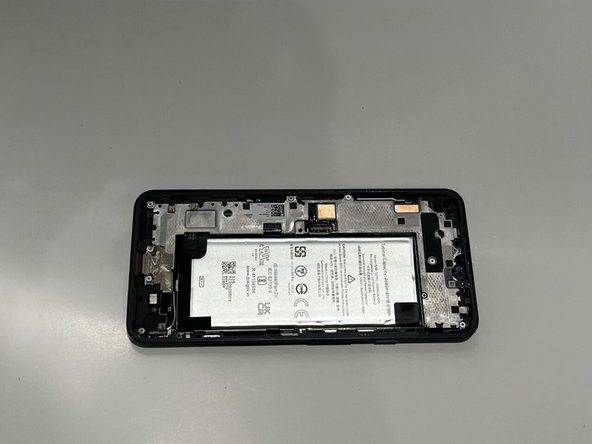

  4. Google Pixel 5a Midframe Replacement, Midframe: crwdns2935265:04crwdnd2935265:01crwdnd2935265:03crwdne2935265:0 Google Pixel 5a Midframe Replacement, Midframe: crwdns2935265:04crwdnd2935265:02crwdnd2935265:03crwdne2935265:0 Google Pixel 5a Midframe Replacement, Midframe: crwdns2935265:04crwdnd2935265:03crwdnd2935265:03crwdne2935265:0

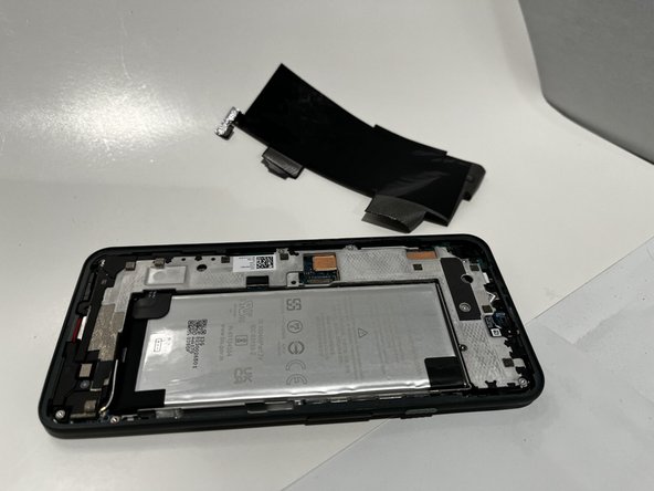

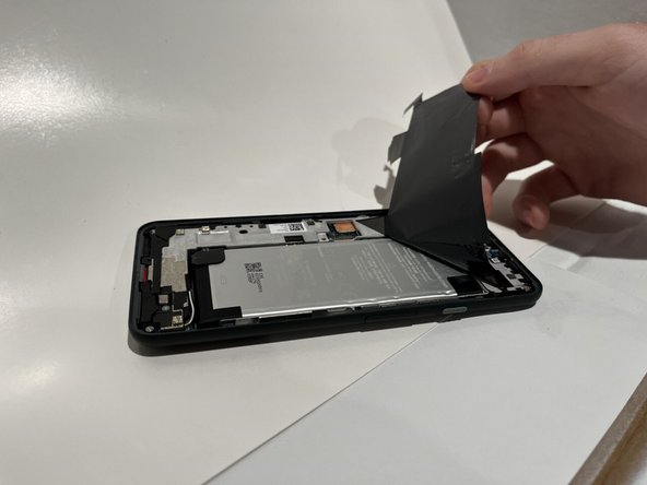

    • Peel back the black plastic film covering the battery.

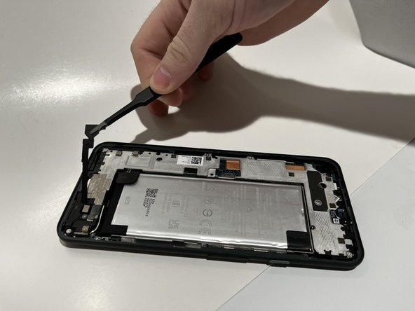

  5. Google Pixel 5a Midframe Replacement: crwdns2935265:05crwdnd2935265:01crwdnd2935265:02crwdne2935265:0 Google Pixel 5a Midframe Replacement: crwdns2935265:05crwdnd2935265:02crwdnd2935265:02crwdne2935265:0

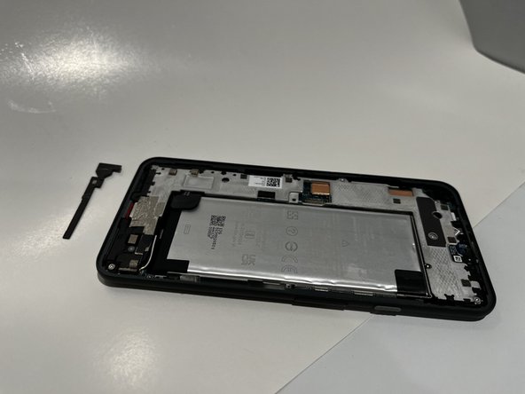

    • Use a pair of tweezers to remove the black plastic cover.

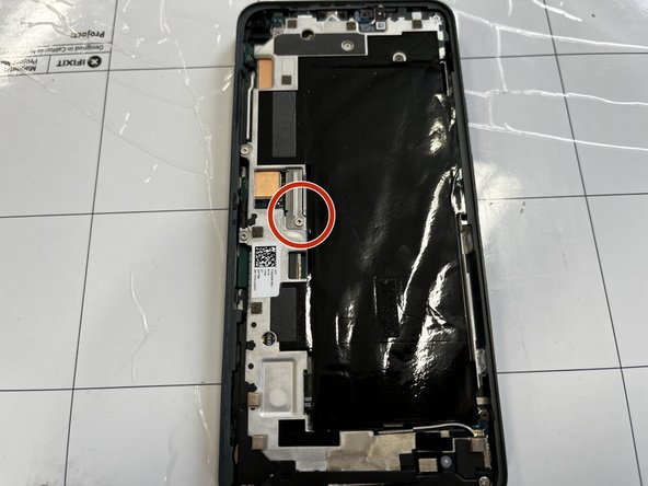

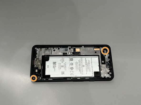

    • Use a spudger to peel back the protective tape covering two screws.

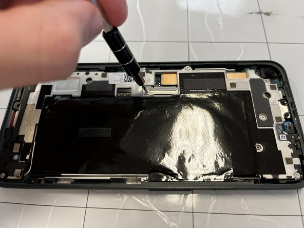

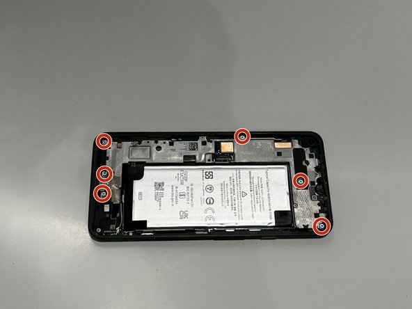

  7. Google Pixel 5a Midframe Replacement: crwdns2935265:07crwdnd2935265:01crwdnd2935265:03crwdne2935265:0 Google Pixel 5a Midframe Replacement: crwdns2935265:07crwdnd2935265:02crwdnd2935265:03crwdne2935265:0 Google Pixel 5a Midframe Replacement: crwdns2935265:07crwdnd2935265:03crwdnd2935265:03crwdne2935265:0
    • Using a T4 screwdriver, remove the six 4 mm screws.
    • Using a T4 screwdriver, remove the two 3 mm screws.
    • Using a T4 screwdriver, remove the 5 mm screw.

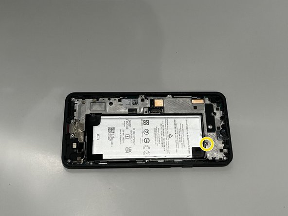

    • Using a T4 screwdriver, remove the single 1 mm screw.

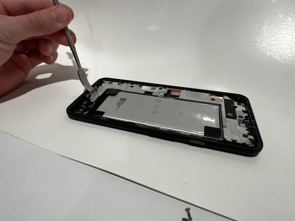

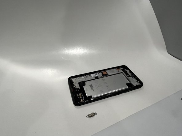

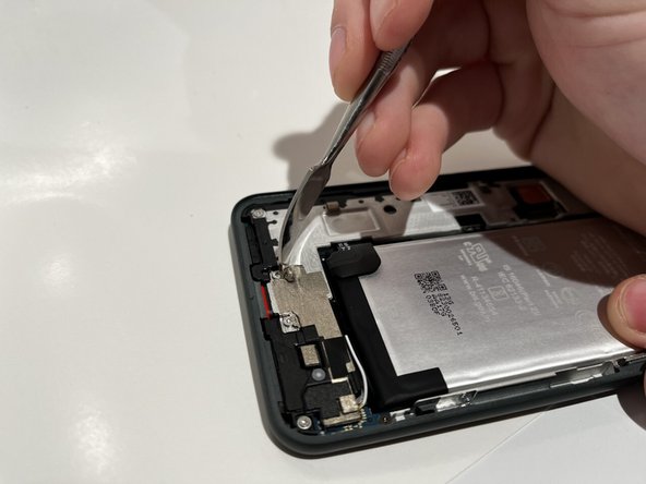

  9. Google Pixel 5a Midframe Replacement: crwdns2935265:09crwdnd2935265:01crwdnd2935265:02crwdne2935265:0 Google Pixel 5a Midframe Replacement: crwdns2935265:09crwdnd2935265:02crwdnd2935265:02crwdne2935265:0

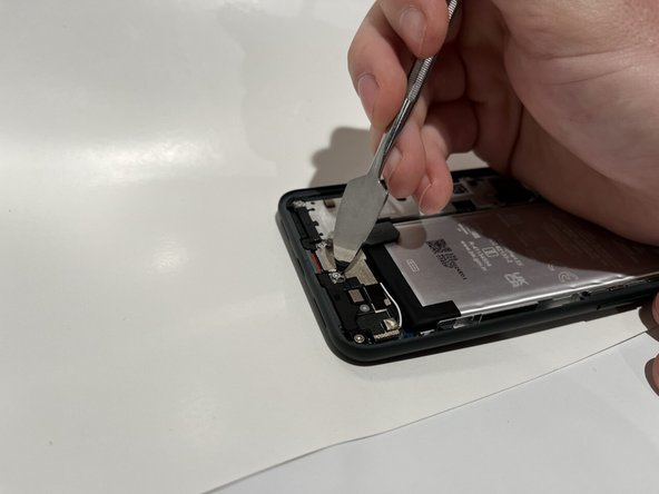

    • Place a spudger under the metal bracket that covers the charging port.
    • Pry the metal bracket upwards, and remove it from the phone.

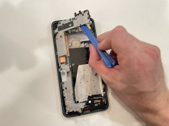

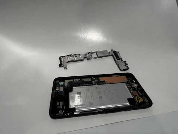

    • Place an opening tool under the midframe.
    • Pry the midframe up, and remove it from the phone.
