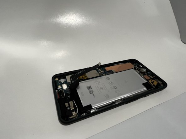

    • Peel back the black plastic film covering the battery.
  5. Google Pixel 5a Battery Replacement: crwdns2935265:05crwdnd2935265:01crwdnd2935265:02crwdne2935265:0 Google Pixel 5a Battery Replacement: crwdns2935265:05crwdnd2935265:02crwdnd2935265:02crwdne2935265:0
    • Use a pair of tweezers to remove the black plastic cover.

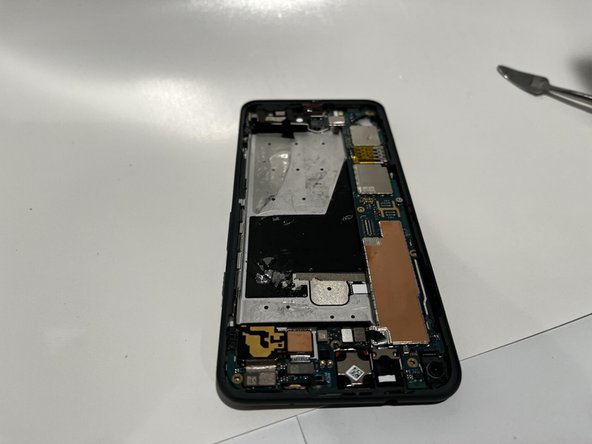

    • Place an opening tool under the midframe.
    • Pry the midframe up, and remove it from the phone.

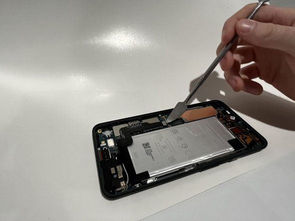

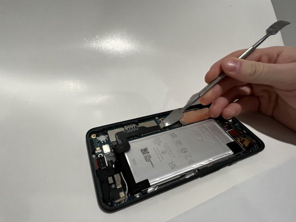

  11. Google Pixel 5a Battery Replacement, Battery: crwdns2935265:011crwdnd2935265:01crwdnd2935265:03crwdne2935265:0 Google Pixel 5a Battery Replacement, Battery: crwdns2935265:011crwdnd2935265:02crwdnd2935265:03crwdne2935265:0 Google Pixel 5a Battery Replacement, Battery: crwdns2935265:011crwdnd2935265:03crwdnd2935265:03crwdne2935265:0
    • Place a spudger under the battery connector and pry upward.

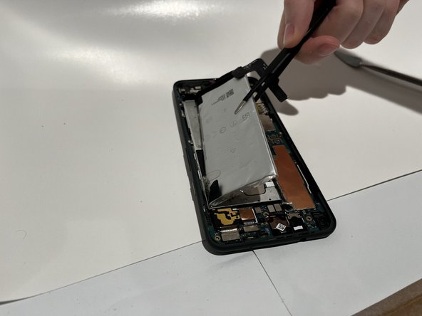

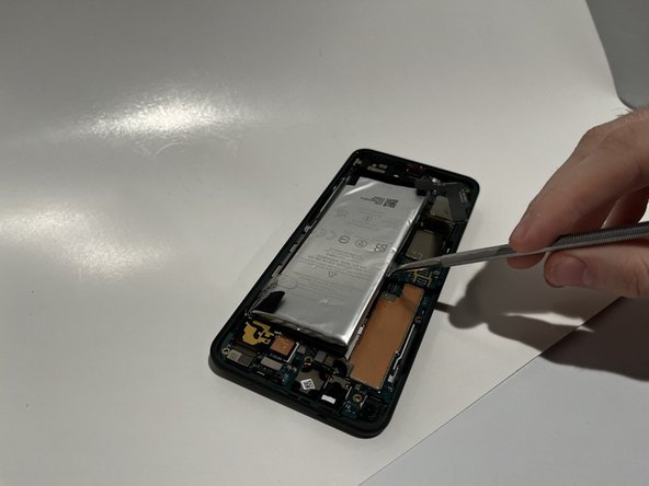

  12. Google Pixel 5a Battery Replacement: crwdns2935265:012crwdnd2935265:01crwdnd2935265:03crwdne2935265:0 Google Pixel 5a Battery Replacement: crwdns2935265:012crwdnd2935265:02crwdnd2935265:03crwdne2935265:0 Google Pixel 5a Battery Replacement: crwdns2935265:012crwdnd2935265:03crwdnd2935265:03crwdne2935265:0
    • Carefully place a spudger under the battery and slowly pry upward.
    • Never use a metal spudger to remove a battery. Metal spudgers can puncture a battery, potentially causing a fire. Use an ESD-safe tool instead, such as an opening tool or nylon spudger.
    • Slowly work the spudger around the battery until loose.
    • Remove the battery from the phone.
