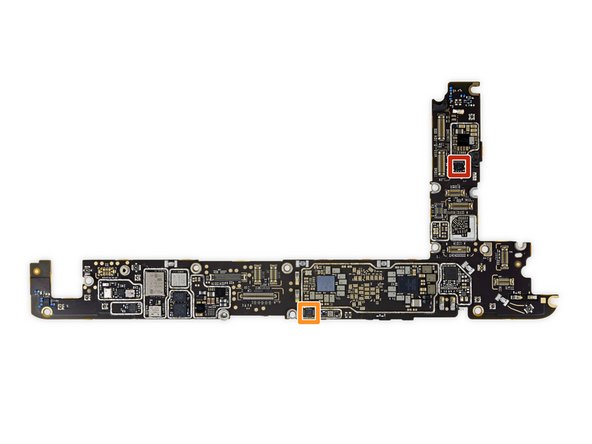

  9. Google Pixel 4 XL Teardown: crwdns2935265:09crwdnd2935265:01crwdnd2935265:02crwdne2935265:0 Google Pixel 4 XL Teardown: crwdns2935265:09crwdnd2935265:02crwdnd2935265:02crwdne2935265:0
    • Chip ID, director's cut part 3:
    • ON Semiconductor EMI8031MUTAG common mode filter w/ ESD protection
    • Texas Instruments TS3A5018 4-ch. SPDT analog switch
    • ON Semiconductor FSUSB242UCX USB-C analog switch
    • Bosch Sensortec BMP380 pressure sensor
    • STMicroelectronics LSM6DSR 3-axis accelerometer/gyroscope
    • STMicroelectronics LIS2MDL 3-axis magnetometer

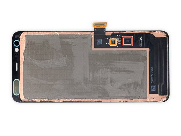

    • Google gifted this Pixel with a supersmooth (sometimes) 90 Hz screen—a rarity thus far, even amongst the flagship-iest of smartphones.
    • Google also made sure nobody could take it from the Pixel without a struggle. Strong perimeter adhesive + screen layers going literally to the edge + giant duct-tape-like adhesive pad = screen does not want to come out intact.
    • In theory there's no reason to do this—only broken screens need be removed this way. But this is not a fun process for replacing an (all too common) broken screen.
    • At least in this case, the result is interesting: this display is manufactured by Samsung! This comes as something of a surprise, given that Samsung has not yet put a 90 Hz display even in its own smartphones.
    • On board, we also find a somewhat unexpected chip package from STMicroelectronics, likely a capacitive touchscreen controller.
    • GigaDevice GD25LH80C 8 Mb serial flash memory
