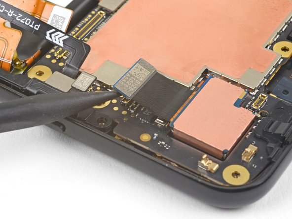

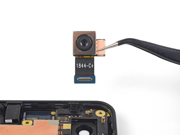

  20. Google Pixel 3a Rear Facing Camera Replacement, Rear Facing Camera: crwdns2935265:020crwdnd2935265:01crwdnd2935265:03crwdne2935265:0 Google Pixel 3a Rear Facing Camera Replacement, Rear Facing Camera: crwdns2935265:020crwdnd2935265:02crwdnd2935265:03crwdne2935265:0 Google Pixel 3a Rear Facing Camera Replacement, Rear Facing Camera: crwdns2935265:020crwdnd2935265:03crwdnd2935265:03crwdne2935265:0
    • Use the point of a spudger to pry up and disconnect the rear facing camera connector from its motherboard socket.
    • Remove the rear facing camera.
