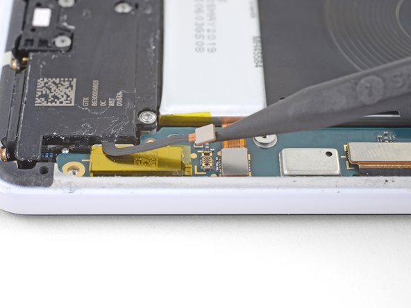

    • Use the point of a spudger to pry up and disconnect the battery connector from its socket.
    • Do not use metal tools to to disconnect the battery, or you will risk shorting the battery.
    • Bend the battery cable such that the connector will not accidentally touch the socket.
  15. Google Pixel 3 XL Loudspeaker Replacement, Disconnect the loudspeaker: crwdns2935265:015crwdnd2935265:01crwdnd2935265:02crwdne2935265:0 Google Pixel 3 XL Loudspeaker Replacement, Disconnect the loudspeaker: crwdns2935265:015crwdnd2935265:02crwdnd2935265:02crwdne2935265:0
    • Use the point of a spudger to pry up and disconnect the loudspeaker connector from its motherboard socket, near the bottom right edge of the phone.

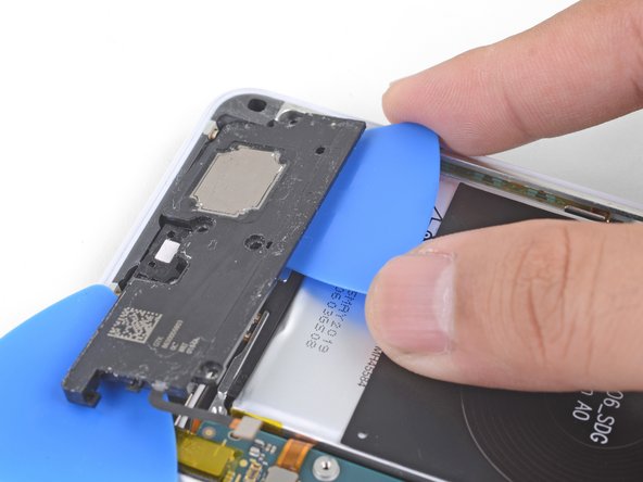

    • Insert the point of an opening pick under the bottom right corner of the loudspeaker.
    • Slide the pick in to loosen the right side of the loudspeaker.
  18. Google Pixel 3 XL Loudspeaker Replacement: crwdns2935265:018crwdnd2935265:01crwdnd2935265:02crwdne2935265:0 Google Pixel 3 XL Loudspeaker Replacement: crwdns2935265:018crwdnd2935265:02crwdnd2935265:02crwdne2935265:0
    • Insert the point of an opening pick under the top edge of the loudspeaker, below the battery.
    • Slide the opening pick in to slice through the adhesive gasket under the loudspeaker.
  19. Google Pixel 3 XL Loudspeaker Replacement, Remove the loudspeaker: crwdns2935265:019crwdnd2935265:01crwdnd2935265:02crwdne2935265:0 Google Pixel 3 XL Loudspeaker Replacement, Remove the loudspeaker: crwdns2935265:019crwdnd2935265:02crwdnd2935265:02crwdne2935265:0
    • Lift the loudspeaker out slowly and pull it away from any remaining adhesive.
    • Remove the loudspeaker.
    • Before you install a replacement loudspeaker, be sure to remove any residual adhesive from the frame.
