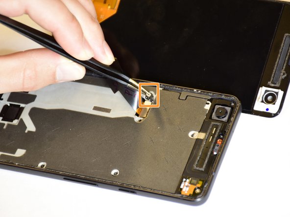

    3. Google Pixel 2 Display Replacement: crwdns2935265:03crwdnd2935265:01crwdnd2935265:03crwdne2935265:0 Google Pixel 2 Display Replacement: crwdns2935265:03crwdnd2935265:02crwdnd2935265:03crwdne2935265:0 Google Pixel 2 Display Replacement: crwdns2935265:03crwdnd2935265:03crwdnd2935265:03crwdne2935265:0
      • Remove the T4 4.0-mm screws from the latch under the display by turning the screwdriver counterclockwise.
      • Pull the latch off of the device by grabbing it with the tweezers and pulling up.

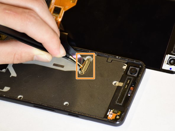

    4. Google Pixel 2 Display Replacement: crwdns2935265:04crwdnd2935265:01crwdnd2935265:01crwdne2935265:0
      • Remove the connector underneath the latch by grabbing it with the tweezers and lifting up.
      • It is normal to hear a popping noise during this step.
      • When reassembling, simply use your finger to pop this piece back into place by pushing it down into the device.
