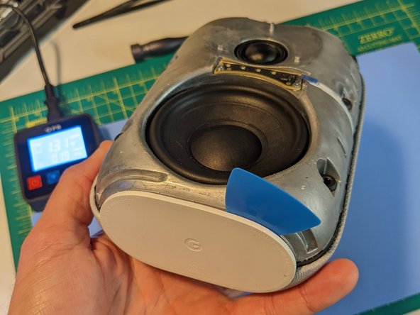

    • The front cover of the device is made of recycled plastic and is press-fit onto the body. It's connected to the body by a flex cable, which can be disconnected easily by hand.
    • To remove the front cover, insert a simple pick into the seam between the front and back housing and gently pry along the seam.
    • If the cover is difficult to remove, you may need to use a flathead screwdriver to rotate and lift it off the body.
    • As the front enclosure starts to loosen, it will begin to "pop" off. Carefully flip up the front enclosure to access the flex cable, and disconnect the cable to remove the front enclosure.

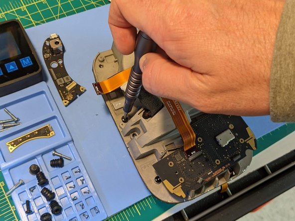

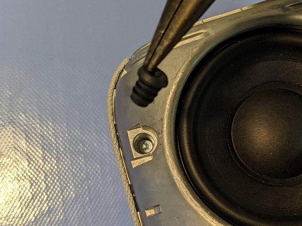

  4. Google Nest Audio Teardown, Rubber Receivers Removal: crwdns2935265:04crwdnd2935265:01crwdnd2935265:02crwdne2935265:0 Google Nest Audio Teardown, Rubber Receivers Removal: crwdns2935265:04crwdnd2935265:02crwdnd2935265:02crwdne2935265:0
    • The aluminum body has six rubber plugs that press-fit into it to hold the front enclosure in place. These plugs need to be removed to access the body screws.
    • Use tweezers or pliers to grab onto the rubber plugs, and gently pull them out. They should pop out easily.

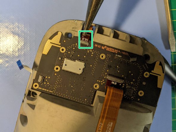

  7. Google Nest Audio Teardown, MLB Flex Cables: crwdns2935265:07crwdnd2935265:01crwdnd2935265:03crwdne2935265:0 Google Nest Audio Teardown, MLB Flex Cables: crwdns2935265:07crwdnd2935265:02crwdnd2935265:03crwdne2935265:0 Google Nest Audio Teardown, MLB Flex Cables: crwdns2935265:07crwdnd2935265:03crwdnd2935265:03crwdne2935265:0

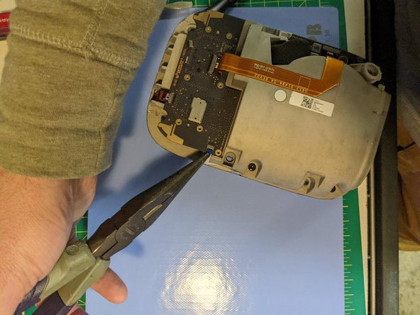

    • At this point, the inner metal core is still sealed, but you should be able to see the main logic board (MLB). However, it's not necessary to remove the MLB to access the speaker. We're only removing it here because this is a teardown.
    • Gently pull on the plastic pull tabs with your fingers, tweezers, or pliers to disconnect the flex cables from the MLB.

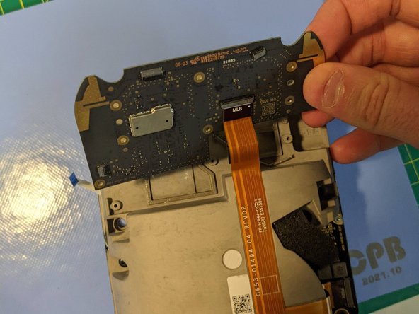

  8. Google Nest Audio Teardown, MLB Removal: crwdns2935265:08crwdnd2935265:01crwdnd2935265:03crwdne2935265:0 Google Nest Audio Teardown, MLB Removal: crwdns2935265:08crwdnd2935265:02crwdnd2935265:03crwdne2935265:0 Google Nest Audio Teardown, MLB Removal: crwdns2935265:08crwdnd2935265:03crwdnd2935265:03crwdne2935265:0
    • Unfasten the seven T6 screws that attach the MLB to the metal core.
    • Remove the MLB from the metal core body.

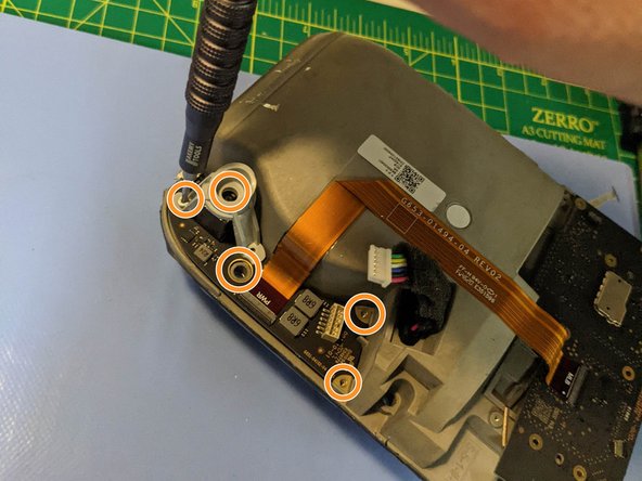

  9. Google Nest Audio Teardown, Daughter Board Removal: crwdns2935265:09crwdnd2935265:01crwdnd2935265:03crwdne2935265:0 Google Nest Audio Teardown, Daughter Board Removal: crwdns2935265:09crwdnd2935265:02crwdnd2935265:03crwdne2935265:0 Google Nest Audio Teardown, Daughter Board Removal: crwdns2935265:09crwdnd2935265:03crwdnd2935265:03crwdne2935265:0
    • There's a separate daughter board that holds the barrel jack power receptacle, distributes power to the MLB and offers a connection terminal for all of the speaker wires.
    • Disconnect the audio cables from the white connector port.
    • Unscrew the five T5 screws.
    • Once the daughter board is free from the metal core, carefully disconnect the main power flex cable that travels to the MLB.

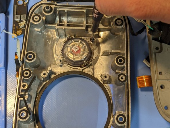

  13. Google Nest Audio Teardown, Speakers Removal: crwdns2935265:013crwdnd2935265:01crwdnd2935265:03crwdne2935265:0 Google Nest Audio Teardown, Speakers Removal: crwdns2935265:013crwdnd2935265:02crwdnd2935265:03crwdne2935265:0 Google Nest Audio Teardown, Speakers Removal: crwdns2935265:013crwdnd2935265:03crwdnd2935265:03crwdne2935265:0
    • Using a T6 driver, remove the six screws holding the speakers.
    • The large speaker is heavy and very magnetic, so be careful when handling it.
    • Lift the speakers out of the housing.
