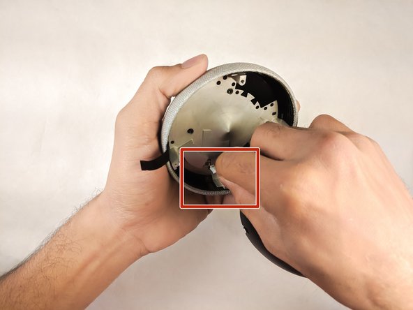

  6. Google Home Mini Speaker Replacement, Speaker: crwdns2935265:06crwdnd2935265:01crwdnd2935265:01crwdne2935265:0
    • Remove the four 7.8mm T8 Torx screws.
  7. Google Home Mini Speaker Replacement: crwdns2935265:07crwdnd2935265:01crwdnd2935265:03crwdne2935265:0 Google Home Mini Speaker Replacement: crwdns2935265:07crwdnd2935265:02crwdnd2935265:03crwdne2935265:0 Google Home Mini Speaker Replacement: crwdns2935265:07crwdnd2935265:03crwdnd2935265:03crwdne2935265:0
    • The speaker will still be connected to the device.
    • Using your fingers, disconnect the wires.
