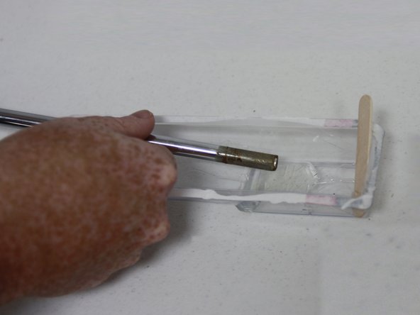

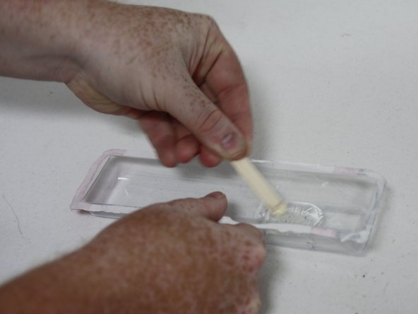

    • Pour epoxy into a container and stir to mix it together. Once epoxy is mixed together, spin the shaft tip into the epoxy to prepare for insertion into the head.

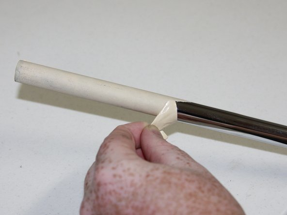

    • Once the grip is cut, remove the grip and peel off the old tape.

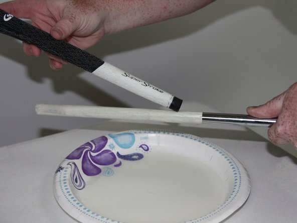

    • Pour grip solvent into the grip, approximately 1/3 full, while holding one finger on the end of the grip to avoid it running out.
    • Shake the grip so the inside of the grip gets all the solvent into it.
    • Pour the excess solvent onto the grip tape around the shaft and have a plate or pan to avoid having a mess. Apply more solvent, if needed, to cover the tape.

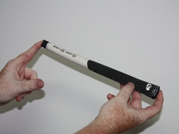

    • Align the grip so the decor is facing up and push the grip straight down the shaft. This step needs to be done as soon as possible to avoid getting the grip stuck.
    • Allow it dry for 2-4 hours so the alignment does not get off.
