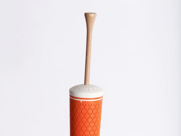

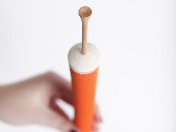

  6. Golf Club Grip Replacement: crwdns2935265:06crwdnd2935265:01crwdnd2935265:03crwdne2935265:0 Golf Club Grip Replacement: crwdns2935265:06crwdnd2935265:02crwdnd2935265:03crwdne2935265:0 Golf Club Grip Replacement: crwdns2935265:06crwdnd2935265:03crwdnd2935265:03crwdne2935265:0
    • Place a golf tee in the hole at the end of the golf grip.
  7. Golf Club Grip Replacement: crwdns2935265:07crwdnd2935265:01crwdnd2935265:02crwdne2935265:0 Golf Club Grip Replacement: crwdns2935265:07crwdnd2935265:02crwdnd2935265:02crwdne2935265:0
    • Pour a generous amount of adhesive into the opposite end of the grip.
    • Squeeze together the open end of the grip.
    • Lightly shake, in order to spread the adhesive within the grip.
