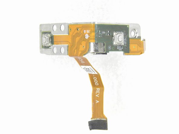

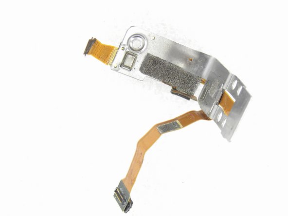

  12. GoPro Hero5 Black Teardown - dead with salt water: crwdns2935265:012crwdnd2935265:01crwdnd2935265:03crwdne2935265:0 GoPro Hero5 Black Teardown - dead with salt water: crwdns2935265:012crwdnd2935265:02crwdnd2935265:03crwdne2935265:0 GoPro Hero5 Black Teardown - dead with salt water: crwdns2935265:012crwdnd2935265:03crwdnd2935265:03crwdne2935265:0
    • Circuito dos botões
