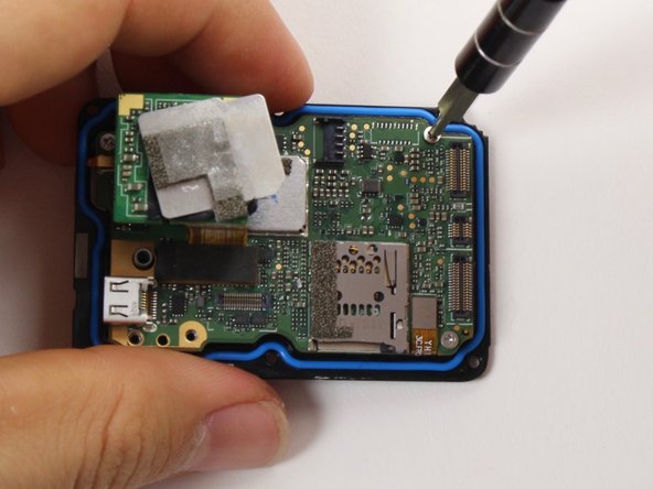

    4. GoPro Hero5 Black Motherboard Replacement: crwdns2935265:06crwdnd2935265:01crwdnd2935265:02crwdne2935265:0 GoPro Hero5 Black Motherboard Replacement: crwdns2935265:06crwdnd2935265:02crwdnd2935265:02crwdne2935265:0
      • Remove the six T3 Torx screws.
    5. GoPro Hero5 Black Motherboard Replacement: crwdns2935265:07crwdnd2935265:01crwdnd2935265:03crwdne2935265:0 GoPro Hero5 Black Motherboard Replacement: crwdns2935265:07crwdnd2935265:02crwdnd2935265:03crwdne2935265:0 GoPro Hero5 Black Motherboard Replacement: crwdns2935265:07crwdnd2935265:03crwdnd2935265:03crwdne2935265:0
      • Be careful when pulling open the motherboard assembly as it is still connected to the back housing by four cables. The cables may break if stretched.
      • Using the spudger, slowly pry open the motherboard assembly from the LCD side of the GoPro.

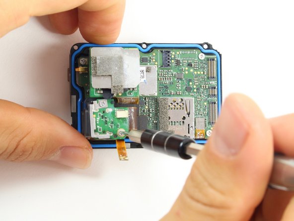

    5. GoPro Hero5 Black Motherboard Replacement: crwdns2935265:014crwdnd2935265:01crwdnd2935265:02crwdne2935265:0 GoPro Hero5 Black Motherboard Replacement: crwdns2935265:014crwdnd2935265:02crwdnd2935265:02crwdne2935265:0
      • Remove the 10mm #000 Phillips screw.

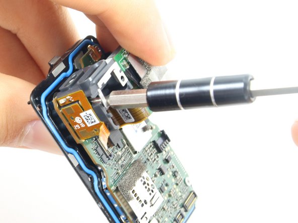

    8. GoPro Hero5 Black Motherboard Replacement: crwdns2935265:017crwdnd2935265:01crwdnd2935265:01crwdne2935265:0
      • Use the flat end of the spudger to pry the lens assembly ribbon cable connector straight up from its socket on the motherboard.

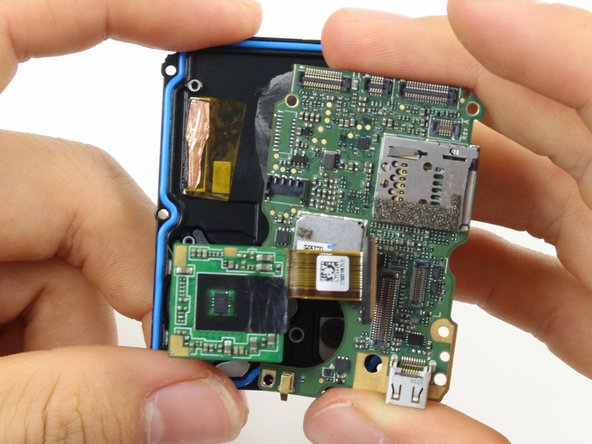

    10. GoPro Hero5 Black Motherboard Replacement: crwdns2935265:019crwdnd2935265:01crwdnd2935265:03crwdne2935265:0 GoPro Hero5 Black Motherboard Replacement: crwdns2935265:019crwdnd2935265:02crwdnd2935265:03crwdne2935265:0 GoPro Hero5 Black Motherboard Replacement: crwdns2935265:019crwdnd2935265:03crwdnd2935265:03crwdne2935265:0
      • Use the flat end of the spudger to pry the motherboard off the midframe.
      • The motherboard is held onto the midframe with light adhesive and should come right off with a little force.
