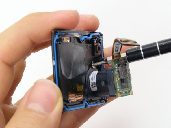

In this guide, you will be removing the lens assembly from the rest of the GoPro. To get to the lens assembly, you must remove almost every other part first. The GoPro Hero5 Black is waterproofed with plenty of adhesives. By completing this guide, you will have to remove the adhesive and your GoPro will no longer be waterproof.

    1. GoPro Hero5 Black Lens Assembly Replacement, Lens Assembly: crwdns2935265:020crwdnd2935265:01crwdnd2935265:02crwdne2935265:0 GoPro Hero5 Black Lens Assembly Replacement, Lens Assembly: crwdns2935265:020crwdnd2935265:02crwdnd2935265:02crwdne2935265:0
      • Remove the 2mm #000 Phillips screws using a #000 Phillips head screwdriver or tool bit.
    2. GoPro Hero5 Black Lens Assembly Replacement: crwdns2935265:021crwdnd2935265:01crwdnd2935265:02crwdne2935265:0 GoPro Hero5 Black Lens Assembly Replacement: crwdns2935265:021crwdnd2935265:02crwdnd2935265:02crwdne2935265:0
      • Pull the lens assembly straight out from the Midframe.

why can't You show how the lens is mount to that assembly? That's the point of it... can we change lenses that way or not?
Polina Luzenco - crwdns2934203:0crwdne2934203:0 crwdns2950251:0crwdne2950251:0
Exactly. Can the actual lens be unscrewed from the mount or it glued / fixed?
contact - crwdns2934203:0crwdne2934203:0 crwdns2950251:0crwdne2950251:0
The lens is heavily glued onto the assembly. It would be far easier to replace the entire assembly than trying to remove that glue.
Christopher Adams - crwdns2934203:0crwdne2934203:0 crwdns2950251:0crwdne2950251:0
the guy who wrote the guide apparently has never heard of pliers. it comes right out, but no idea what the threading is.
