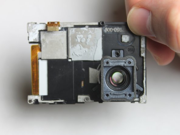

    1. GoPro Hero4 Silver Motherboard Replacement, Speaker Assembly: crwdns2935265:09crwdnd2935265:01crwdnd2935265:02crwdne2935265:0 GoPro Hero4 Silver Motherboard Replacement, Speaker Assembly: crwdns2935265:09crwdnd2935265:02crwdnd2935265:02crwdne2935265:0
      • Use a pair of tweezers to disconnect the ribbon cable from the ZIF connector by flipping up the black retaining flap. You should then be able to pull the cable free.
      • Once the ribbon cable is disconnected, you can remove the black plastic bracket which holds the camera lens.
      • Be careful removing the ribbon cable. It is very fragile and can tear.

Do step 9 before step 6. It's near impossible to get the middle screw out in the order the guide presents. There's also a screw that isn't mentioned that needs to be removed in order to complete step 9. You can see the screw in step 6's picture right above the QR bar code.
