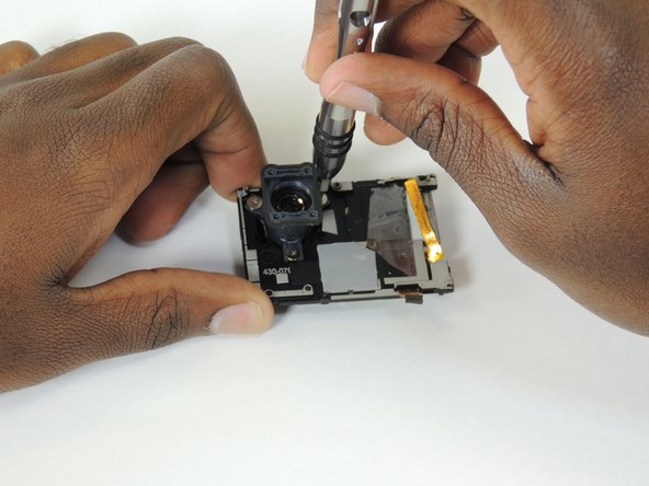

  5. GoPro Hero4 Black Lens Replacement, Camera Sensor: crwdns2935265:05crwdnd2935265:01crwdnd2935265:03crwdne2935265:0 GoPro Hero4 Black Lens Replacement, Camera Sensor: crwdns2935265:05crwdnd2935265:02crwdnd2935265:03crwdne2935265:0 GoPro Hero4 Black Lens Replacement, Camera Sensor: crwdns2935265:05crwdnd2935265:03crwdnd2935265:03crwdne2935265:0
    • Using a plastic opening tool, separate the camera sensor's connector from the motherboard.
  6. GoPro Hero4 Black Lens Replacement: crwdns2935265:06crwdnd2935265:01crwdnd2935265:03crwdne2935265:0 GoPro Hero4 Black Lens Replacement: crwdns2935265:06crwdnd2935265:02crwdnd2935265:03crwdne2935265:0 GoPro Hero4 Black Lens Replacement: crwdns2935265:06crwdnd2935265:03crwdnd2935265:03crwdne2935265:0
    • Using a #00 Phillips head screwdriver, remove the four 3.0mm screws holding the camera sensor.
  7. GoPro Hero4 Black Lens Replacement, Lens: crwdns2935265:07crwdnd2935265:01crwdnd2935265:02crwdne2935265:0 GoPro Hero4 Black Lens Replacement, Lens: crwdns2935265:07crwdnd2935265:02crwdnd2935265:02crwdne2935265:0
    • Using a #00 Phillips head screwdriver, remove the following screws:
    • Three 2 mm screw
  8. GoPro Hero4 Black Lens Replacement: crwdns2935265:08crwdnd2935265:01crwdnd2935265:01crwdne2935265:0
    • Lift the lens from the front housing.
