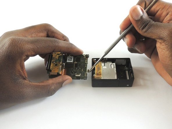

    • Insert a metal spudger between the back plastic housing and the camera board assembly. Working around the edge to be careful of the inner components, carefully remove the camera.

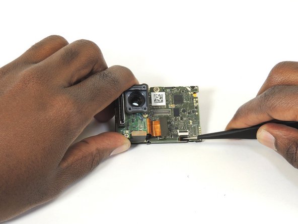

    • Using tweezers, remove the ribbon strip by pulling on it. This will remove the connection.
    • Push down on the three wires with the metal spudger and the clip will disconnect from the motherboard.
    • The clip must be pulled up and away from the motherboard. Attempting to slide it out will damage the clip.
    • During reassembly, remove the black tape on the ribbon cable, turn the camera upside down so you can see the port, and reinsert the cable with tweezers. It's a lot easier!

    • Open the clip that is located on the motherboard
    • Use a pair of tweezers to pull the ribbon from the clip

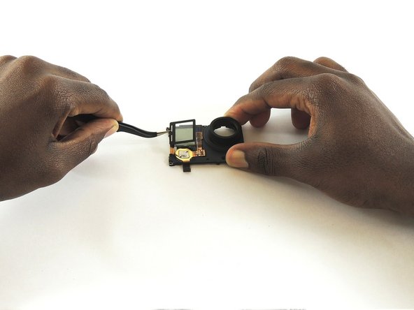

    • Before you start this step flip the section holding the LCD screen over
    • Place the iOpener on the LCD screen cover to release the glue
    • Lift the covering of the LCD screen cover off with a pair of tweezers

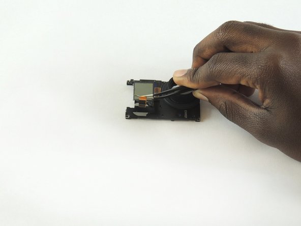

    • Use a pair of tweezers to lift the ribbon through the opening and lift all the way up to the LCD screen
    • A section of our LCD screen ribbon was broken so it is not visible from the image.

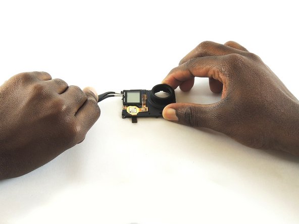

    • Place the iOpener on the LCD screen to remove the glue
    • Use a pair of tweezers to left the LCD screen off the device
