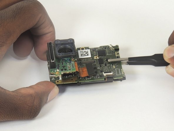

    • Insert a metal spudger between the back plastic housing and the camera board assembly. Working around the edge to be careful of the inner components, carefully remove the camera.
  4. GoPro Hero4 Black Expansion Port/Motherboard Replacement: crwdns2935265:04crwdnd2935265:01crwdnd2935265:03crwdne2935265:0 GoPro Hero4 Black Expansion Port/Motherboard Replacement: crwdns2935265:04crwdnd2935265:02crwdnd2935265:03crwdne2935265:0 GoPro Hero4 Black Expansion Port/Motherboard Replacement: crwdns2935265:04crwdnd2935265:03crwdnd2935265:03crwdne2935265:0
    • Using tweezers, remove the ribbon strip by pulling on it. This will remove the connection.
    • Push down on the three wires with the metal spudger and the clip will disconnect from the motherboard.
    • The clip must be pulled up and away from the motherboard. Attempting to slide it out will damage the clip.
    • During reassembly, remove the black tape on the ribbon cable, turn the camera upside down so you can see the port, and reinsert the cable with tweezers. It's a lot easier!

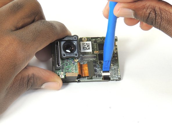

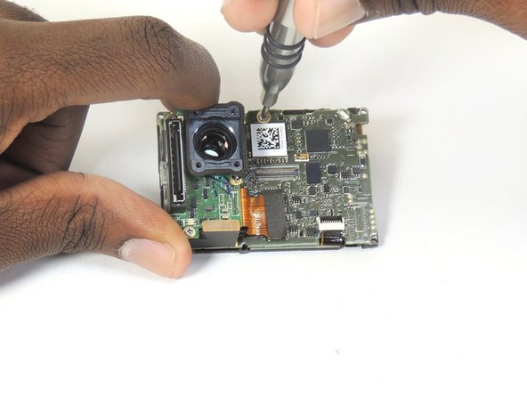

  5. GoPro Hero4 Black Expansion Port/Motherboard Replacement, Camera Sensor: crwdns2935265:05crwdnd2935265:01crwdnd2935265:03crwdne2935265:0 GoPro Hero4 Black Expansion Port/Motherboard Replacement, Camera Sensor: crwdns2935265:05crwdnd2935265:02crwdnd2935265:03crwdne2935265:0 GoPro Hero4 Black Expansion Port/Motherboard Replacement, Camera Sensor: crwdns2935265:05crwdnd2935265:03crwdnd2935265:03crwdne2935265:0
    • Using a plastic opening tool, separate the camera sensor's connector from the motherboard.

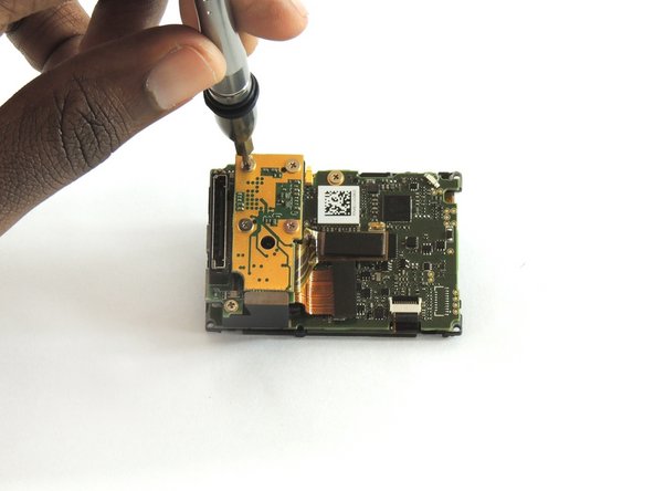

  6. GoPro Hero4 Black Expansion Port/Motherboard Replacement: crwdns2935265:06crwdnd2935265:01crwdnd2935265:03crwdne2935265:0 GoPro Hero4 Black Expansion Port/Motherboard Replacement: crwdns2935265:06crwdnd2935265:02crwdnd2935265:03crwdne2935265:0 GoPro Hero4 Black Expansion Port/Motherboard Replacement: crwdns2935265:06crwdnd2935265:03crwdnd2935265:03crwdne2935265:0
    • Using a #00 Phillips head screwdriver, remove the four 3.0mm screws holding the camera sensor.

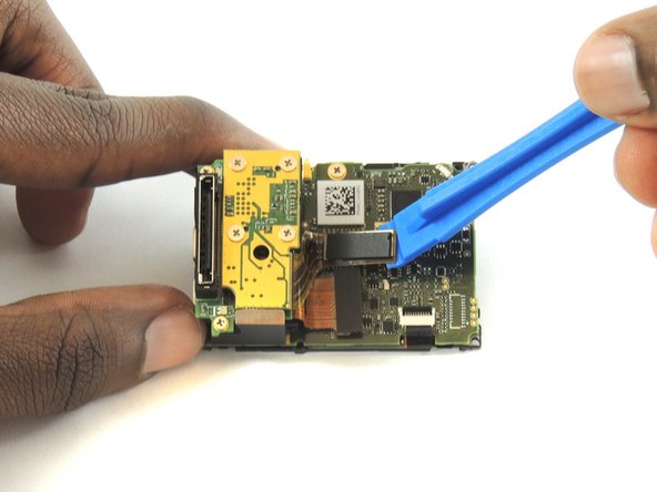

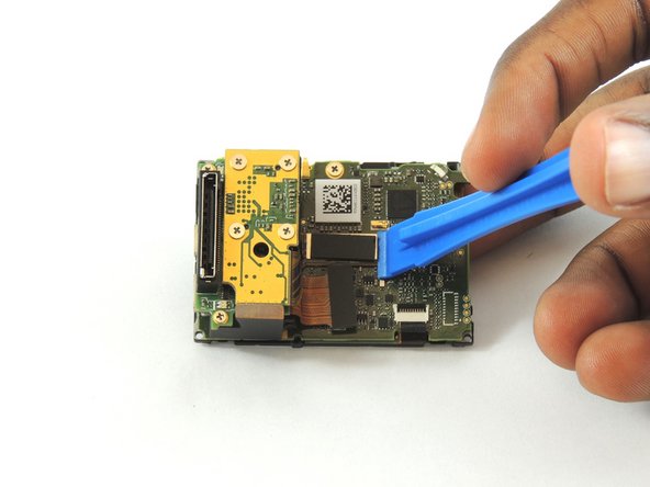

  7. GoPro Hero4 Black Expansion Port/Motherboard Replacement, Expansion Port: crwdns2935265:07crwdnd2935265:01crwdnd2935265:03crwdne2935265:0 GoPro Hero4 Black Expansion Port/Motherboard Replacement, Expansion Port: crwdns2935265:07crwdnd2935265:02crwdnd2935265:03crwdne2935265:0 GoPro Hero4 Black Expansion Port/Motherboard Replacement, Expansion Port: crwdns2935265:07crwdnd2935265:03crwdnd2935265:03crwdne2935265:0
    • Using #00 phillips head screwdriver, remove the 3.0mm screw.
    • Using the plastic opening tool, unclip the LCD ribbon from the motherboard.

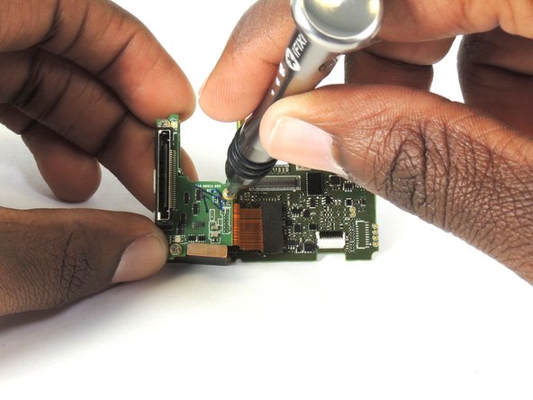

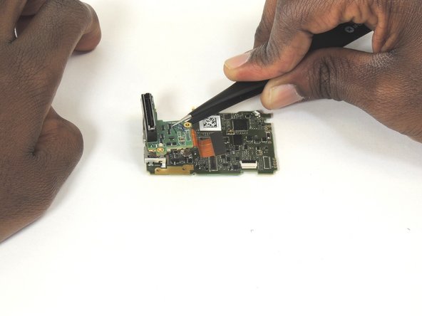

  9. GoPro Hero4 Black Expansion Port/Motherboard Replacement: crwdns2935265:09crwdnd2935265:01crwdnd2935265:03crwdne2935265:0 GoPro Hero4 Black Expansion Port/Motherboard Replacement: crwdns2935265:09crwdnd2935265:02crwdnd2935265:03crwdne2935265:0 GoPro Hero4 Black Expansion Port/Motherboard Replacement: crwdns2935265:09crwdnd2935265:03crwdnd2935265:03crwdne2935265:0
    • Using #00 phillips head screwdriver, remove the three 4.0mm screws.
    • Using plastic opening tool, unclip Expansion Port chip from motherboard
    • A metal piece of the frame sits underneath the bottom screw, which will detach upon removing the screw.

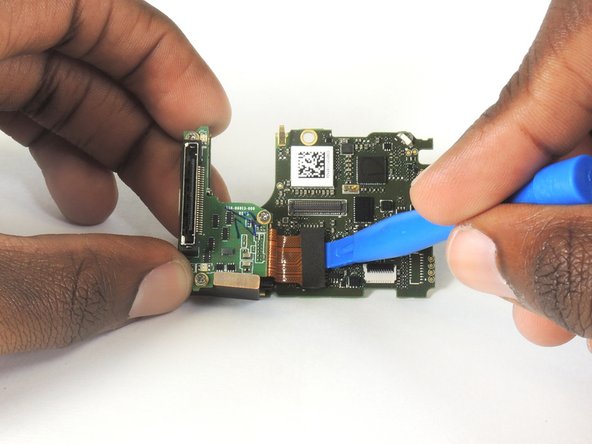

  10. GoPro Hero4 Black Expansion Port/Motherboard Replacement: crwdns2935265:010crwdnd2935265:01crwdnd2935265:02crwdne2935265:0 GoPro Hero4 Black Expansion Port/Motherboard Replacement: crwdns2935265:010crwdnd2935265:02crwdnd2935265:02crwdne2935265:0
    • Lift the expansion port chip from the motherboard.
    • It is now possible to replace the expansion port and/or motherboard.
