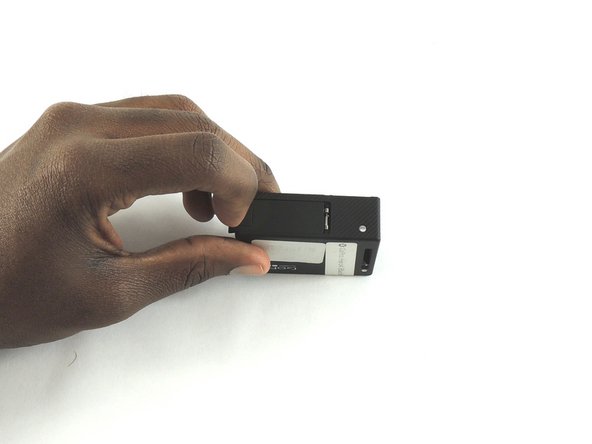

    • Remove the faceplate by carefully prying around the edge using a plastic opening tool. Loosen the clips on the edge, then pull the faceplate off.
    • Use the tweezers to lift the faceplate from the rest of the device.
    • The power button on the front of the GoPro may pop off. Ensure to align it properly during reassembly.

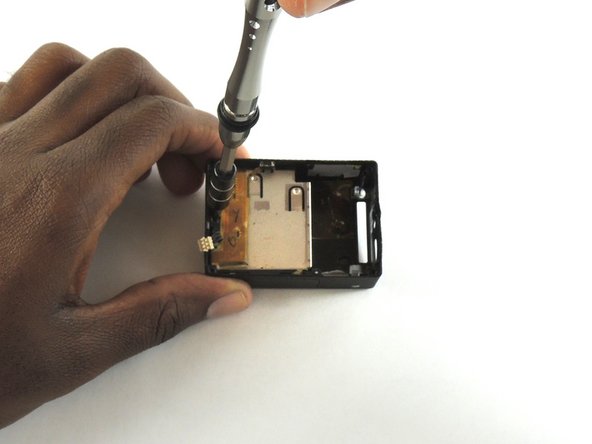

    • Insert a metal spudger between the back plastic housing and the camera board assembly. Working around the edge to be careful of the inner components, carefully remove the camera.

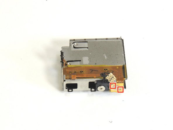

  5. GoPro Hero4 Black Battery Housing and Rear Frame Replacement, Battery Housing and Rear Frame: crwdns2935265:05crwdnd2935265:01crwdnd2935265:02crwdne2935265:0 GoPro Hero4 Black Battery Housing and Rear Frame Replacement, Battery Housing and Rear Frame: crwdns2935265:05crwdnd2935265:02crwdnd2935265:02crwdne2935265:0
    • Using a #00 phillips head screwdriver, remove the two 3.0mm screws
    • The top screw is missing from our device, but it is in the approximate location of the top circle.

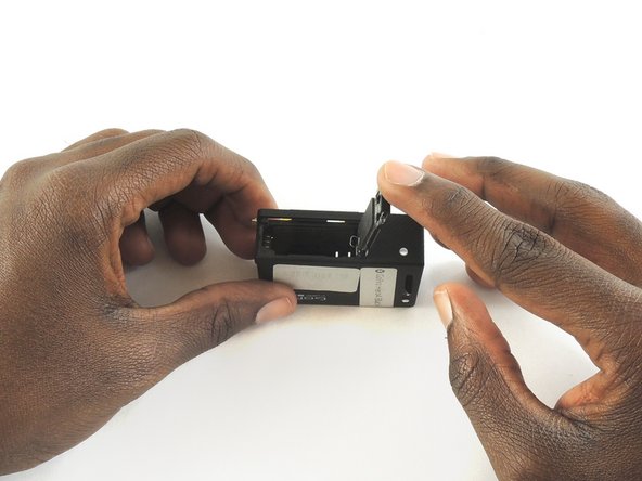

    • Be sure to lift the battery cover before proceeding.

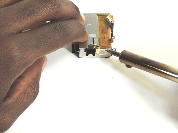

    • De-solder the shutter button board from the battery enclosure.
    • In case you are new to soldering, here is Ifixit's soldering guide
    • 3rd party sellers have the battery housing with the shutter button board already attached. If you have purchased this, begin reassembly.
