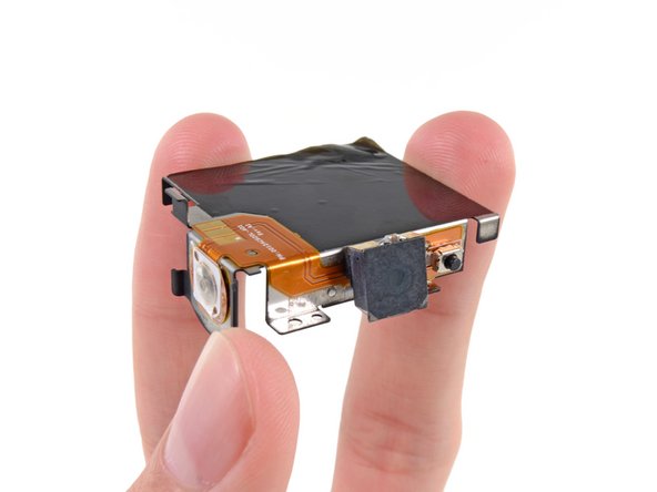

  14. GoPro Hero3 Teardown: crwdns2935265:014crwdnd2935265:01crwdnd2935265:03crwdne2935265:0 GoPro Hero3 Teardown: crwdns2935265:014crwdnd2935265:02crwdnd2935265:03crwdne2935265:0 GoPro Hero3 Teardown: crwdns2935265:014crwdnd2935265:03crwdnd2935265:03crwdne2935265:0
    • More tape, more screws, moar fun!
    • A few more Phillips screws stand in the way of pulling out the "ultra sharp ƒ/2.8 6-element aspherical glass lens."
    • Honestly, we just had a lot of fun looking at our guitar picks through this lens—here's another look through the Hero3's eye now that it's free of the motherboard.
    • Because why? Because science.

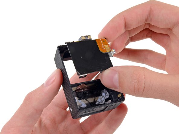

    • There are only a few components left around the device casing.
    • Last on the midframe is the LCD and its soldered-on cable. Repairability takes a hit here, when we have to pull out a heat gun and metal spudger to loosen the adhesive securing this cable to the midframe.
    • The rear case's last component is the button/speaker assembly which is attached to the backing of the battery compartment. A couple of screws and some tape hold it in place.

    • GoPro HD Hero3 Repairability Score: 7 out of 10 (10 is easiest to repair)
    • The battery is intended to be easily replaced by the user, and requires no tools to access.
    • The entire device can be disassembled with readily-available tools.
    • Modular design throughout allows replacement of several individual components.
    • Minimal adhesive securing the front cover can be difficult to separate, but poses no real challenge to opening.
    • Fragile copper grounding tape can be difficult to peel and replace.
    • Because the display cable is adhered to the midframe, replacing the LCD requires use of a heat gun.
