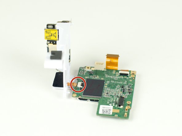

    1. GoPro Hero LCD Screen Replacement, LCD Screen: crwdns2935265:07crwdnd2935265:01crwdnd2935265:02crwdne2935265:0 GoPro Hero LCD Screen Replacement, LCD Screen: crwdns2935265:07crwdnd2935265:02crwdnd2935265:02crwdne2935265:0
      • Remove the larger ribbon cable from the daughter board by lifting the black latch and pulling the ribbon cable gently from the socket.
      • Disconnect the smaller ribbon cable leading from the white plastic piece by simply pulling it from the socket.
    2. GoPro Hero LCD Screen Replacement: crwdns2935265:08crwdnd2935265:01crwdnd2935265:01crwdne2935265:0
      • Separate the motherboard from the white piece of plastic.
    3. GoPro Hero LCD Screen Replacement: crwdns2935265:09crwdnd2935265:01crwdnd2935265:01crwdne2935265:0
      • Remove the ribbon cable from the motherboard by simply pulling the cable from the socket.
    4. GoPro Hero LCD Screen Replacement: crwdns2935265:010crwdnd2935265:01crwdnd2935265:02crwdne2935265:0 GoPro Hero LCD Screen Replacement: crwdns2935265:010crwdnd2935265:02crwdnd2935265:02crwdne2935265:0
      • Separate the LCD screen from the motherboard.
