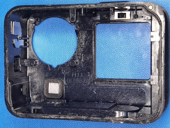

    • In the picture below, the GoPro Hero 9 is completely disassembled.
    • Since GoPro Hero 9 Black and GoPro Hero 10 Black are almost identical, the disassembling process is the same
    • Please note that you have to cut into the back of your camera and that it will not look the same as it did before.
    • Your camera may not be waterproof after reassembly. Suggested use of waterproof housing if your camera is required to be waterproof

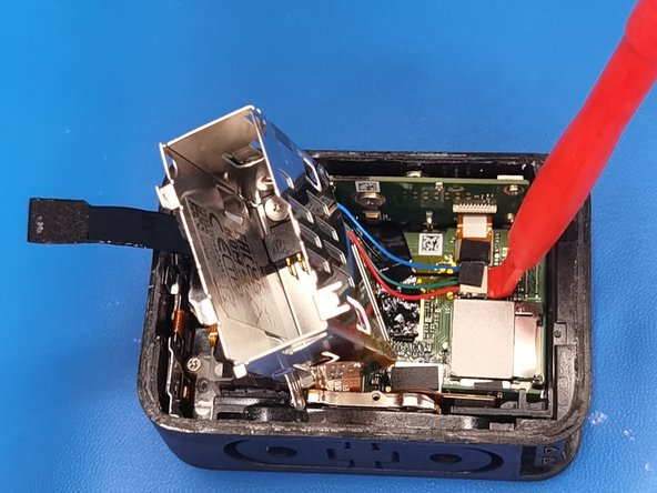

    • De-attach both screen cables
    • Remove rear screen cable extension and black plastic cable

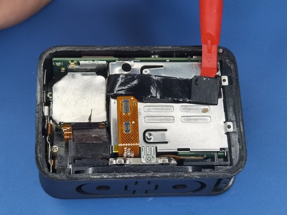

  4. GoPro Hero 9 and 10 Black Disassembly, Battery cage removal: crwdns2935265:04crwdnd2935265:01crwdnd2935265:03crwdne2935265:0 GoPro Hero 9 and 10 Black Disassembly, Battery cage removal: crwdns2935265:04crwdnd2935265:02crwdnd2935265:03crwdne2935265:0 GoPro Hero 9 and 10 Black Disassembly, Battery cage removal: crwdns2935265:04crwdnd2935265:03crwdnd2935265:03crwdne2935265:0
    • To remove the battery cage you will first need to remove three philips head screws
    • Lift the battery cage and disconnect the cable from the motherboard

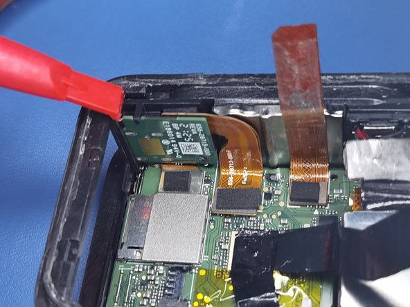

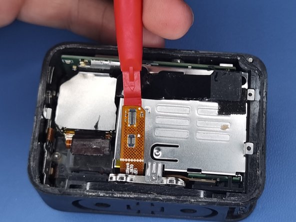

  5. GoPro Hero 9 and 10 Black Disassembly, Charging port removal: crwdns2935265:05crwdnd2935265:01crwdnd2935265:02crwdne2935265:0 GoPro Hero 9 and 10 Black Disassembly, Charging port removal: crwdns2935265:05crwdnd2935265:02crwdnd2935265:02crwdne2935265:0
    • First disconnect power cable
    • Apply pressure with a pry tool from the position as shown in the second picture (It should come out with minimum force)
    • Be careful not to damage the ribbon cable

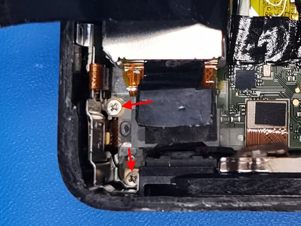

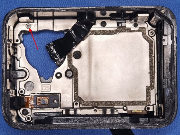

  6. GoPro Hero 9 and 10 Black Disassembly, Plastic bracket removal: crwdns2935265:06crwdnd2935265:01crwdnd2935265:02crwdne2935265:0 GoPro Hero 9 and 10 Black Disassembly, Plastic bracket removal: crwdns2935265:06crwdnd2935265:02crwdnd2935265:02crwdne2935265:0
    • Remove black plastic cable
    • Remove two philips head screws

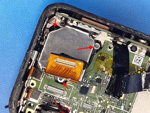

  7. GoPro Hero 9 and 10 Black Disassembly, Camera removal: crwdns2935265:07crwdnd2935265:01crwdnd2935265:02crwdne2935265:0 GoPro Hero 9 and 10 Black Disassembly, Camera removal: crwdns2935265:07crwdnd2935265:02crwdnd2935265:02crwdne2935265:0
    • Disconnect camera cable
    • Remove three screws as shown in the picture

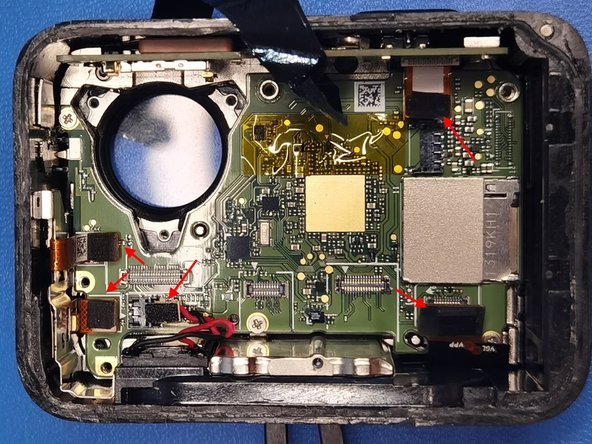

  8. GoPro Hero 9 and 10 Black Disassembly, Motherboard removal - part 1 (cables): crwdns2935265:08crwdnd2935265:01crwdnd2935265:02crwdne2935265:0 GoPro Hero 9 and 10 Black Disassembly, Motherboard removal - part 1 (cables): crwdns2935265:08crwdnd2935265:02crwdnd2935265:02crwdne2935265:0

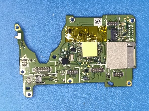

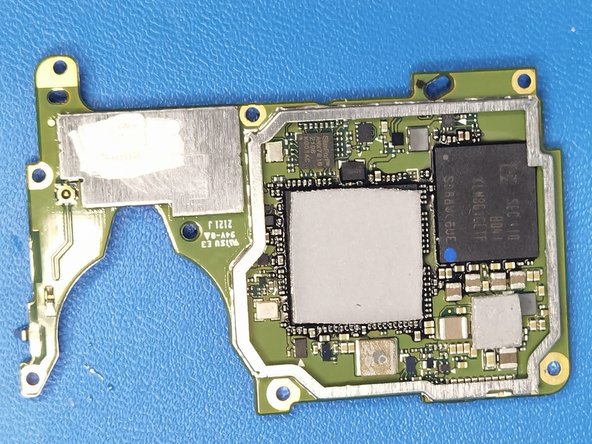

    • Disconnect all remaining cables
  9. GoPro Hero 9 and 10 Black Disassembly, Motherboard removal - part 2: crwdns2935265:09crwdnd2935265:01crwdnd2935265:03crwdne2935265:0 GoPro Hero 9 and 10 Black Disassembly, Motherboard removal - part 2: crwdns2935265:09crwdnd2935265:02crwdnd2935265:03crwdne2935265:0 GoPro Hero 9 and 10 Black Disassembly, Motherboard removal - part 2: crwdns2935265:09crwdnd2935265:03crwdnd2935265:03crwdne2935265:0
    • Remove three philips head screws

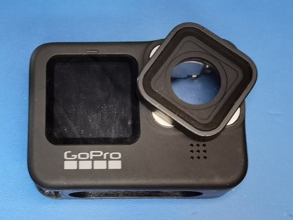

  13. GoPro Hero 9 and 10 Black Disassembly, Mounting bracket + Lens cover removal: crwdns2935265:013crwdnd2935265:01crwdnd2935265:02crwdne2935265:0 GoPro Hero 9 and 10 Black Disassembly, Mounting bracket + Lens cover removal: crwdns2935265:013crwdnd2935265:02crwdnd2935265:02crwdne2935265:0
    • To remove GoPro mounting bracket you have to remove four TX 5 screws
    • When removing lens cover you will have to twist counter clock wise. It can require more strength if you are removing it for the first time

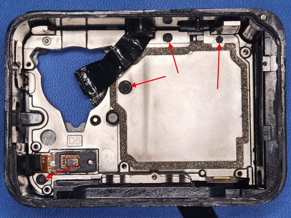

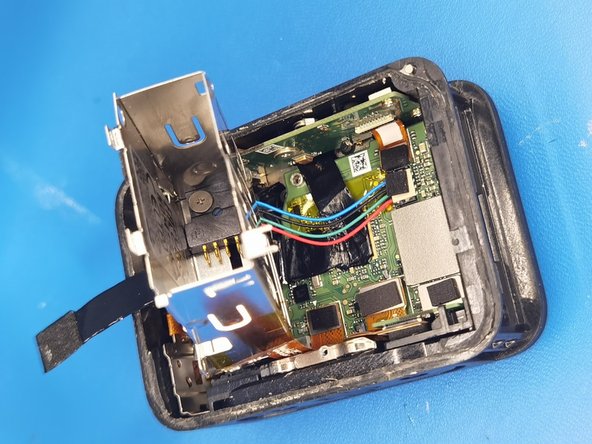

  14. GoPro Hero 9 and 10 Black Disassembly, Metal roll cage removal: crwdns2935265:014crwdnd2935265:01crwdnd2935265:03crwdne2935265:0 GoPro Hero 9 and 10 Black Disassembly, Metal roll cage removal: crwdns2935265:014crwdnd2935265:02crwdnd2935265:03crwdne2935265:0 GoPro Hero 9 and 10 Black Disassembly, Metal roll cage removal: crwdns2935265:014crwdnd2935265:03crwdnd2935265:03crwdne2935265:0
    • First, remove four TX4 screws from the front of the GoPro
    • Then remove one TX4 Screw from the inside of the GoPro as shown in the picture
    • In some occasions, you can remove the cage by applying enough force from the front of the GoPro where the lens cover was, but in my case i had to use a precision knife to chip away four melted plastic pins for easier removal and then apply force

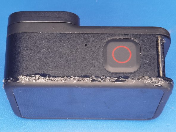

  16. GoPro Hero 9 and 10 Black Disassembly, Reassembling: crwdns2935265:016crwdnd2935265:01crwdnd2935265:02crwdne2935265:0 GoPro Hero 9 and 10 Black Disassembly, Reassembling: crwdns2935265:016crwdnd2935265:02crwdnd2935265:02crwdne2935265:0
    • Follow the steps above in reverse direction for reassembly
    • Apply glue on the borders of the camera as shown in the first picture with red line [Recommended glue: E6000]
    • Recommend you to use some sort of clamp to pressure togather screen and the GoPro frame
    • E6000 ADHESIVE can take anywhere from 24h up to 72h to reach its maximum bond
    • In the second picture you can see how the GoPro looks after
    • Suggested use of waterproof housing if your camera is required to be waterproof
