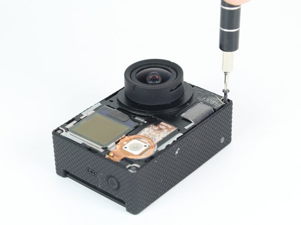

      • Now that the faceplate is off, it is time to remove the 4 screws on each corner.
      • Use the T4 tool bit from the iFixit toolkit in order to remove the 4 screws on each corner.

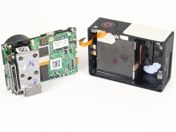

      • Use the spudger to gently pry off the connector of the housing to the motherboard.
      • You should now have the motherboard assembly and the housing separated.

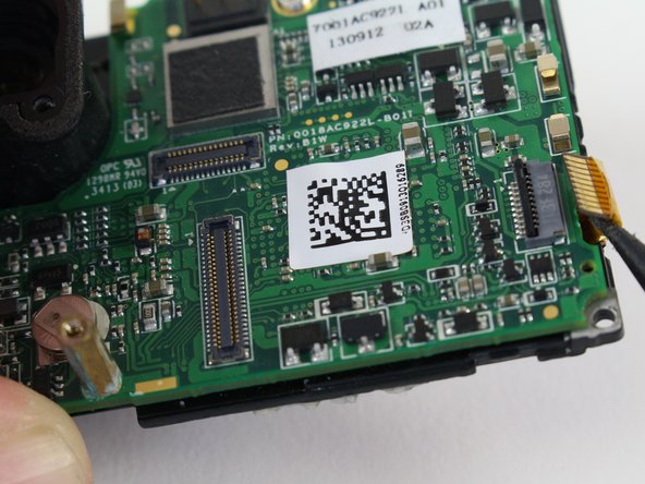

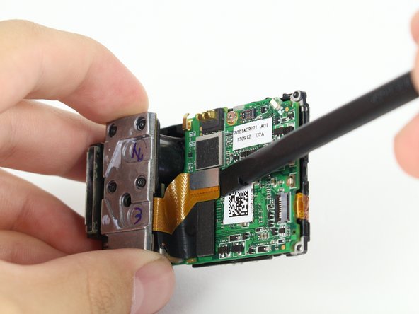

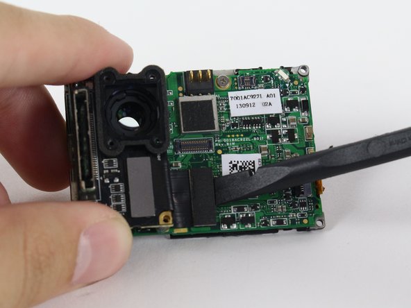

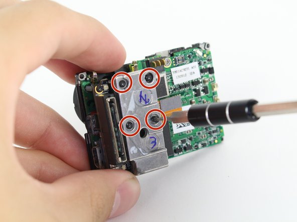

      • Use the spudger to remove the heat shield tape and detach the image sensor from the motherboard.
      • Using the T4 Torx toolbit, remove the 4 screws that connect the sensor to the lens.
      • Remove the silver connector of the image sensor from the motherboard using the spudger to pry it off.

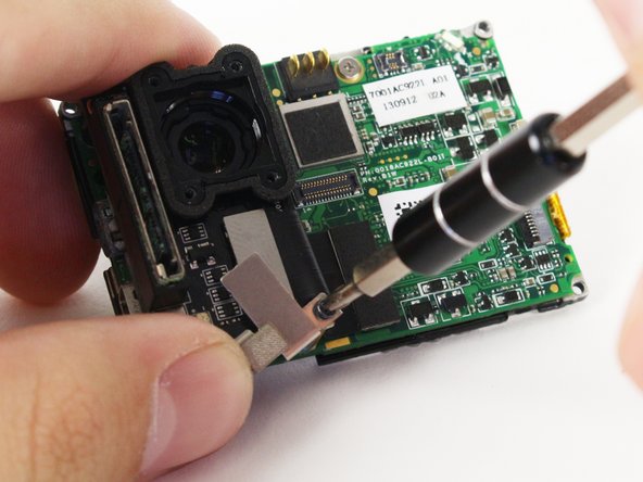

      • The media adapter is attached to the motherboard via 3 screws:
      • x1 T4 Torx
      • x2 Phillips #00
      • There's a little silver bracket that is held down by the Phillips #00 screw so be careful not to lose it.
      • With a little prying, use the spudger to detach the media adapter's connector from the motherboard.

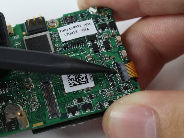

      • Use the spudger to lift the black tab up to unlock.
      • Then remove LCD screen connector by sliding out.

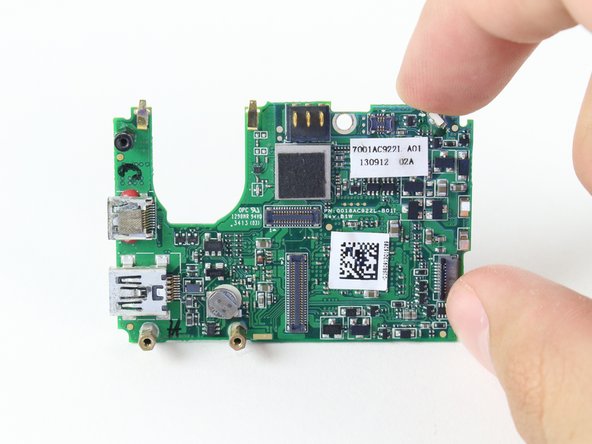

    8. GoPro Hero 3 Silver Motherboard Replacement: crwdns2935265:010crwdnd2935265:01crwdnd2935265:03crwdne2935265:0 GoPro Hero 3 Silver Motherboard Replacement: crwdns2935265:010crwdnd2935265:02crwdnd2935265:03crwdne2935265:0 GoPro Hero 3 Silver Motherboard Replacement: crwdns2935265:010crwdnd2935265:03crwdnd2935265:03crwdne2935265:0
      • Using the Phillips head bit, remove the silver screw near the top edge of the board.
      • Separate the LCD assembly by pulling it away. You should have the bare motherboard!
