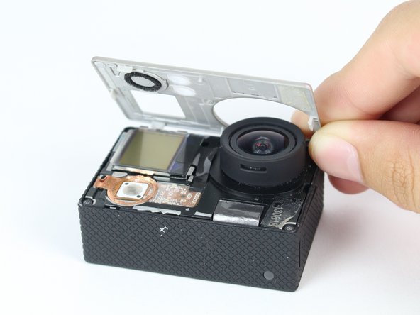

  3. GoPro Hero 3 Silver LCD Housing Replacement, LCD Housing: crwdns2935265:03crwdnd2935265:01crwdnd2935265:02crwdne2935265:0 GoPro Hero 3 Silver LCD Housing Replacement, LCD Housing: crwdns2935265:03crwdnd2935265:02crwdnd2935265:02crwdne2935265:0
    • Use the plastic opening tool to remove the faceplate.
    • There is some adhesive and clips so be careful and the faceplate should pop right off.

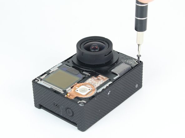

  4. GoPro Hero 3 Silver LCD Housing Replacement: crwdns2935265:04crwdnd2935265:01crwdnd2935265:02crwdne2935265:0 GoPro Hero 3 Silver LCD Housing Replacement: crwdns2935265:04crwdnd2935265:02crwdnd2935265:02crwdne2935265:0
    • Now that the faceplate is off, it is time to remove the 4 screws on each corner.
    • Use the T4 tool bit from the iFixit toolkit in order to remove the 4 screws on each corner.

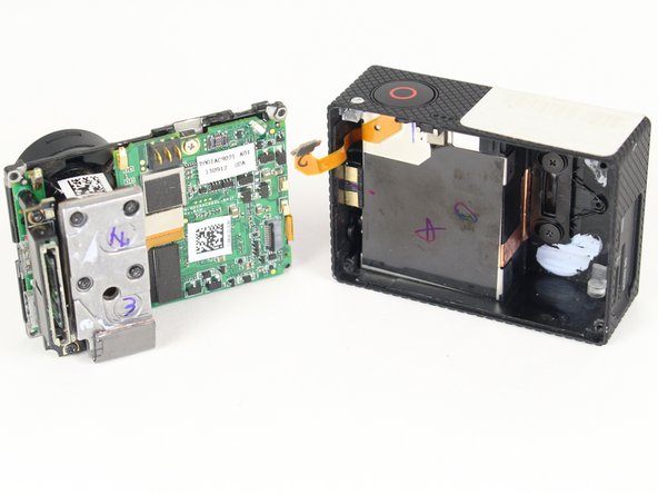

    • Using the plastic opening tool, slowly pry open the motherboard assembly.
  6. GoPro Hero 3 Silver LCD Housing Replacement: crwdns2935265:06crwdnd2935265:01crwdnd2935265:02crwdne2935265:0 GoPro Hero 3 Silver LCD Housing Replacement: crwdns2935265:06crwdnd2935265:02crwdnd2935265:02crwdne2935265:0

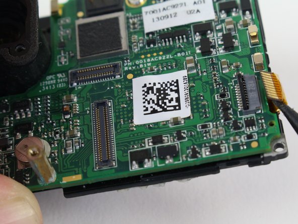

    • Use the spudger to gently pry off the connector of the housing to the motherboard.
    • You should now have the motherboard assembly and the housing separated.

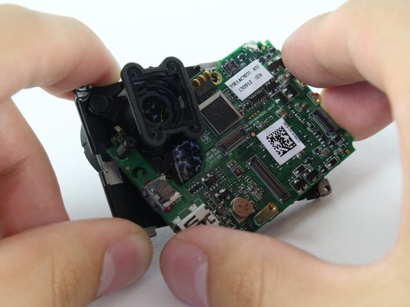

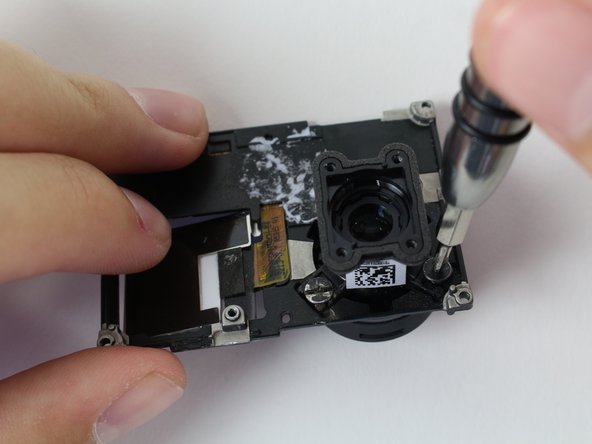

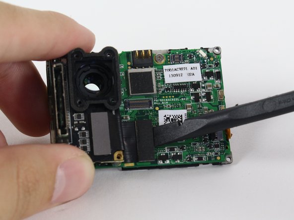

  7. GoPro Hero 3 Silver LCD Housing Replacement: crwdns2935265:07crwdnd2935265:01crwdnd2935265:03crwdne2935265:0 GoPro Hero 3 Silver LCD Housing Replacement: crwdns2935265:07crwdnd2935265:02crwdnd2935265:03crwdne2935265:0 GoPro Hero 3 Silver LCD Housing Replacement: crwdns2935265:07crwdnd2935265:03crwdnd2935265:03crwdne2935265:0

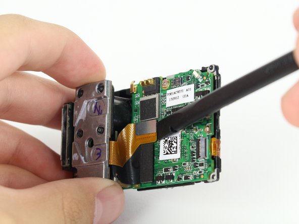

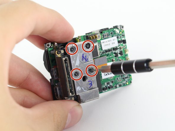

    • Use the spudger to remove the heat shield tape and detach the image sensor from the motherboard.
    • Using the T4 Torx toolbit, remove the 4 screws that connect the sensor to the lens.
    • Remove the silver connector of the image sensor from the motherboard using the spudger to pry it off.

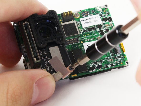

    • The media adapter is attached to the motherboard via 3 screws:
    • x1 T4 Torx
    • x2 Phillips #00
    • There's a little silver bracket that is held down by the Phillips #00 screw so be careful not to lose it.
    • With a little prying, use the spudger to detach the media adapter's connector from the motherboard.

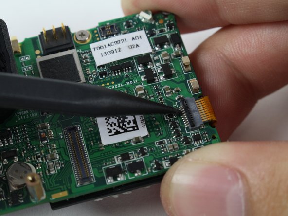

    • Use the spudger to lift the black tab up to unlock.
    • Then remove LCD screen connector by sliding out.

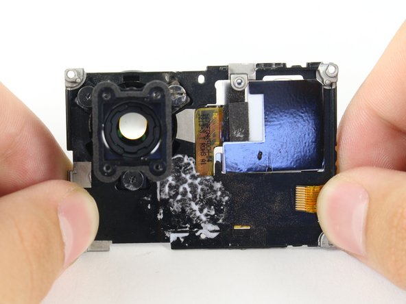

  11. GoPro Hero 3 Silver LCD Housing Replacement: crwdns2935265:011crwdnd2935265:01crwdnd2935265:02crwdne2935265:0 GoPro Hero 3 Silver LCD Housing Replacement: crwdns2935265:011crwdnd2935265:02crwdnd2935265:02crwdne2935265:0
    • There are 3 Phillips #00 screws holding the lens onto the LCD housing that need to be removed.
    • Our screw on the top right is stripped, which is why it looks different. However, they will all look the same in your device.
  12. GoPro Hero 3 Silver LCD Housing Replacement: crwdns2935265:012crwdnd2935265:01crwdnd2935265:02crwdne2935265:0 GoPro Hero 3 Silver LCD Housing Replacement: crwdns2935265:012crwdnd2935265:02crwdnd2935265:02crwdne2935265:0

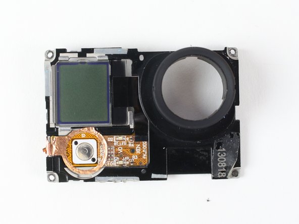

    • Carefully remove the camera lens from the LCD Housing.
    • Now you have the LCD housing removed!
