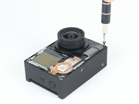

  4. GoPro Hero 3 Silver Image Sensor Replacement: crwdns2935265:04crwdnd2935265:01crwdnd2935265:02crwdne2935265:0 GoPro Hero 3 Silver Image Sensor Replacement: crwdns2935265:04crwdnd2935265:02crwdnd2935265:02crwdne2935265:0
    • Now that the faceplate is off, it is time to remove the 4 screws on each corner.
    • Use the T4 tool bit from the iFixit toolkit in order to remove the 4 screws on each corner.

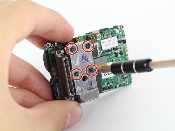

  5. GoPro Hero 3 Silver Image Sensor Replacement: crwdns2935265:05crwdnd2935265:01crwdnd2935265:02crwdne2935265:0 GoPro Hero 3 Silver Image Sensor Replacement: crwdns2935265:05crwdnd2935265:02crwdnd2935265:02crwdne2935265:0
    • Note: Make sure you remove the door cover of the USB, mini HDMI, and SD port before. Separating the motherboard will be easier.
    • Using the plastic opening tool, slowly pry open the motherboard assembly.

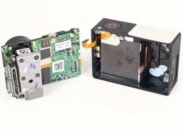

  6. GoPro Hero 3 Silver Image Sensor Replacement: crwdns2935265:06crwdnd2935265:01crwdnd2935265:02crwdne2935265:0 GoPro Hero 3 Silver Image Sensor Replacement: crwdns2935265:06crwdnd2935265:02crwdnd2935265:02crwdne2935265:0
    • Use the spudger to gently pry off the connector of the housing to the motherboard.
    • You should now have the motherboard assembly and the housing separated.

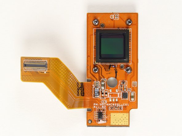

  7. GoPro Hero 3 Silver Image Sensor Replacement: crwdns2935265:07crwdnd2935265:01crwdnd2935265:02crwdne2935265:0 GoPro Hero 3 Silver Image Sensor Replacement: crwdns2935265:07crwdnd2935265:02crwdnd2935265:02crwdne2935265:0
    • Use the spudger to remove the heat shield tape and detach the image sensor from the motherboard.
    • Using the T4 Torx toolbit, remove the 4 screws that connect the sensor to the lens.
  8. GoPro Hero 3 Silver Image Sensor Replacement: crwdns2935265:08crwdnd2935265:01crwdnd2935265:02crwdne2935265:0 GoPro Hero 3 Silver Image Sensor Replacement: crwdns2935265:08crwdnd2935265:02crwdnd2935265:02crwdne2935265:0
    • Remove the silver connector of the image sensor from the motherboard using the spudger to pry it off.
    • You should now be able to remove the image sensor by simply pulling it.
