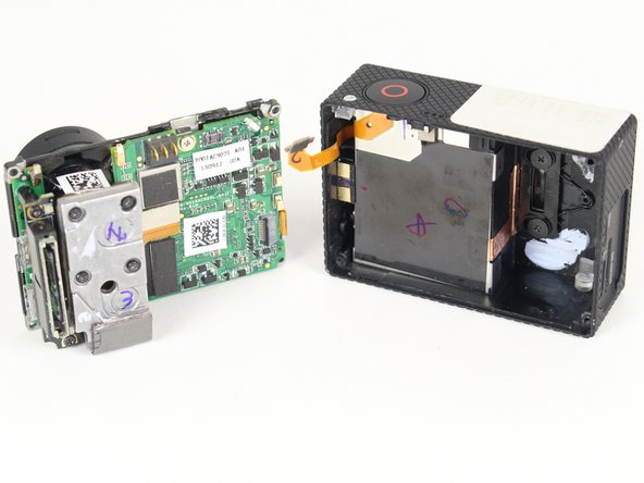

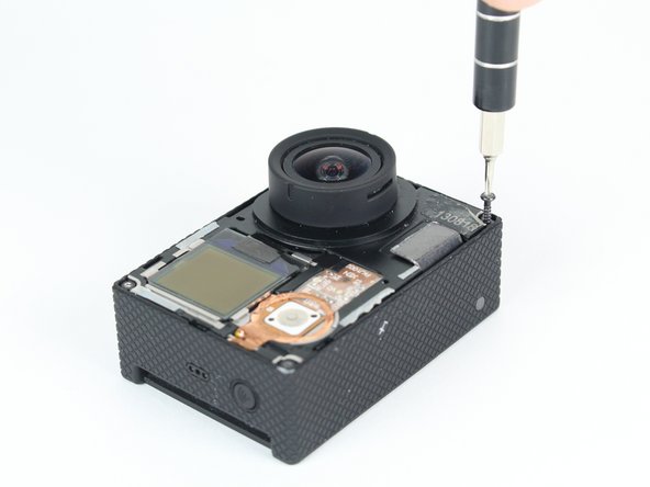

    • Now that the faceplate is off, it is time to remove the 4 screws on each corner.
    • Use the T4 tool bit from the iFixit toolkit in order to remove the 4 screws on each corner.
  5. GoPro Hero 3 Silver Camera Lens Replacement: crwdns2935265:05crwdnd2935265:01crwdnd2935265:02crwdne2935265:0 GoPro Hero 3 Silver Camera Lens Replacement: crwdns2935265:05crwdnd2935265:02crwdnd2935265:02crwdne2935265:0

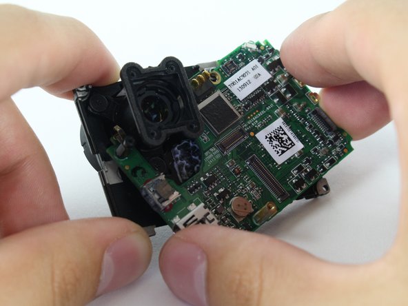

    • Note: Make sure you remove the door cover of the USB, mini HDMI, and SD port before. Separating the motherboard will be easier.
    • Using the plastic opening tool, slowly pry open the motherboard assembly.
  6. GoPro Hero 3 Silver Camera Lens Replacement: crwdns2935265:06crwdnd2935265:01crwdnd2935265:02crwdne2935265:0 GoPro Hero 3 Silver Camera Lens Replacement: crwdns2935265:06crwdnd2935265:02crwdnd2935265:02crwdne2935265:0
    • Use the spudger to gently pry off the connector of the housing to the motherboard.
    • You should now have the motherboard assembly and the housing separated.

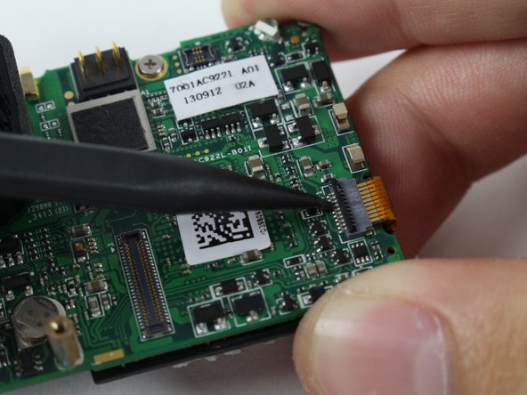

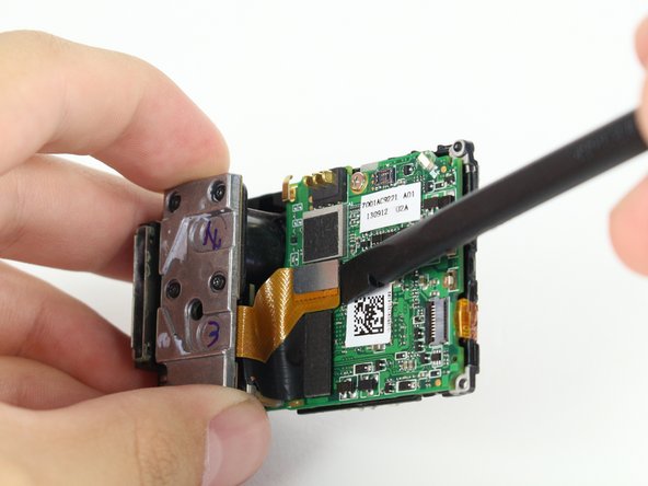

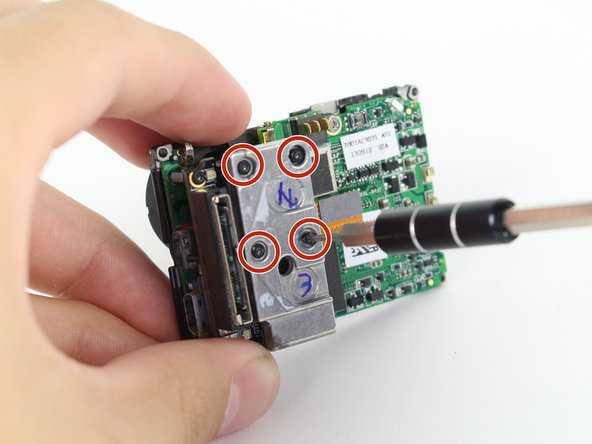

    • Use the spudger to remove the heat shield tape and detach the image sensor from the motherboard.
    • Using the T4 Torx toolbit, remove the 4 screws that connect the sensor to the lens.

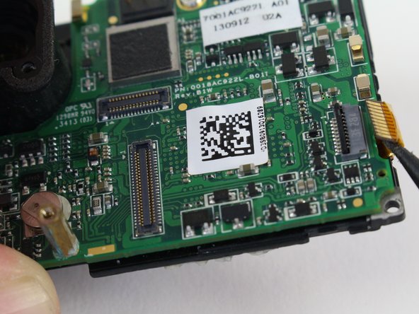

    • Remove the silver connector of the image sensor from the motherboard using the spudger to pry it off.

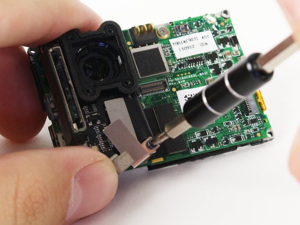

    • The media adapter is attached to the motherboard via 3 screws:
    • x1 T4 Torx
    • x2 Phillips #00
    • There is a little silver bracket (in the yellow circle) that is held down by the Phillips #00 screw so be careful not to lose it.
    • With a little prying, use the spudger to detach the media adapter's connector from the motherboard.

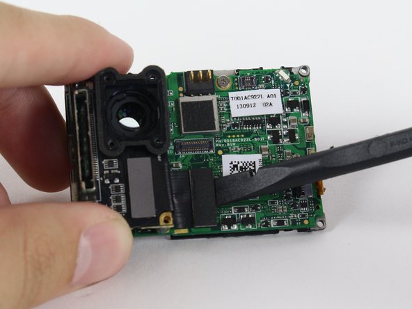

    • Use the spudger to lift the black tab up to unlock.
    • Then remove LCD screen connector by sliding out.
