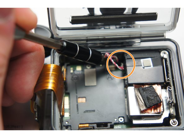

  5. GoPro Hero+ LCD Motherboard Replacement: crwdns2935265:05crwdnd2935265:01crwdnd2935265:01crwdne2935265:0
    • Using tweezers, peel off the copper tape on the right side of the battery.
  6. GoPro Hero+ LCD Motherboard Replacement: crwdns2935265:06crwdnd2935265:01crwdnd2935265:02crwdne2935265:0 GoPro Hero+ LCD Motherboard Replacement: crwdns2935265:06crwdnd2935265:02crwdnd2935265:02crwdne2935265:0
    • Place the plastic opening tool at one of the edges of the battery then pry until the battery is removed from the GoPro.
  7. GoPro Hero+ LCD Motherboard Replacement: crwdns2935265:07crwdnd2935265:01crwdnd2935265:01crwdne2935265:0
    • Use a pair of tweezers to disconnect the battery connector from the motherboard.
    • Gently pull the battery off the motherboard. Pulling vertically off the motherboard will give a clean release.

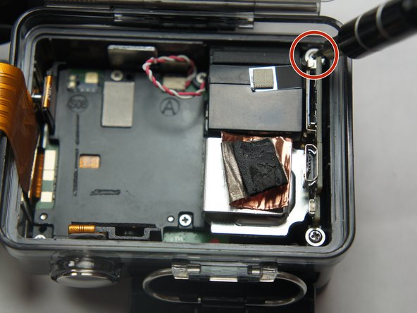

  8. GoPro Hero+ LCD Motherboard Replacement, MicroSD/Micro USB Port Assembly: crwdns2935265:08crwdnd2935265:01crwdnd2935265:03crwdne2935265:0 GoPro Hero+ LCD Motherboard Replacement, MicroSD/Micro USB Port Assembly: crwdns2935265:08crwdnd2935265:02crwdnd2935265:03crwdne2935265:0 GoPro Hero+ LCD Motherboard Replacement, MicroSD/Micro USB Port Assembly: crwdns2935265:08crwdnd2935265:03crwdnd2935265:03crwdne2935265:0
    • Remove the two 6 mm Phillips #00 screws.
    • Remove the single 4 mm Phillips #000 screws.

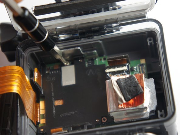

  9. GoPro Hero+ LCD Motherboard Replacement: crwdns2935265:09crwdnd2935265:01crwdnd2935265:01crwdne2935265:0
    • Remove the image sensor from the camera.
    • You do not have to unplug the black box to remove the USB/SD chip.

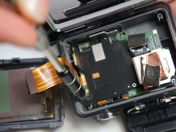

  10. GoPro Hero+ LCD Motherboard Replacement: crwdns2935265:010crwdnd2935265:01crwdnd2935265:01crwdne2935265:0
    • Grab the edge of the ribbon cable with the tweezers and gently pull until the cable is disconnected from the motherboard.
    • Be careful when removing the ribbon cable. You must pull gently or you can rip the ribbon off of its contacts.

  12. GoPro Hero+ LCD Motherboard Replacement, Image Sensor: crwdns2935265:012crwdnd2935265:01crwdnd2935265:01crwdne2935265:0
    • Use your fingers and gently pull out the sensor from the motherboard by slowly and gradually pulling up on the image sensor box.
    • Do not yank on the image sensor, it can rip out the wiring or damage the motherboard.

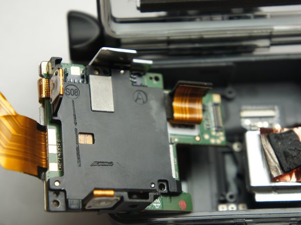

  13. GoPro Hero+ LCD Motherboard Replacement, Motherboard: crwdns2935265:013crwdnd2935265:01crwdnd2935265:03crwdne2935265:0 GoPro Hero+ LCD Motherboard Replacement, Motherboard: crwdns2935265:013crwdnd2935265:02crwdnd2935265:03crwdne2935265:0 GoPro Hero+ LCD Motherboard Replacement, Motherboard: crwdns2935265:013crwdnd2935265:03crwdnd2935265:03crwdne2935265:0
    • Remove the three 4 mm Phillips #000 screws securing the motherboard.

  15. GoPro Hero+ LCD Motherboard Replacement: crwdns2935265:015crwdnd2935265:01crwdnd2935265:03crwdne2935265:0 GoPro Hero+ LCD Motherboard Replacement: crwdns2935265:015crwdnd2935265:02crwdnd2935265:03crwdne2935265:0 GoPro Hero+ LCD Motherboard Replacement: crwdns2935265:015crwdnd2935265:03crwdnd2935265:03crwdne2935265:0
    • Use your fingers and carefully pull out the motherboard from under the lens. It may take a little bit of adjusting to get it out.
