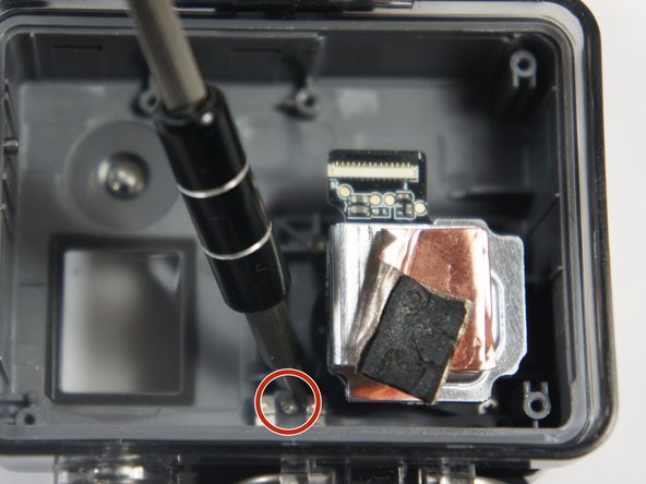

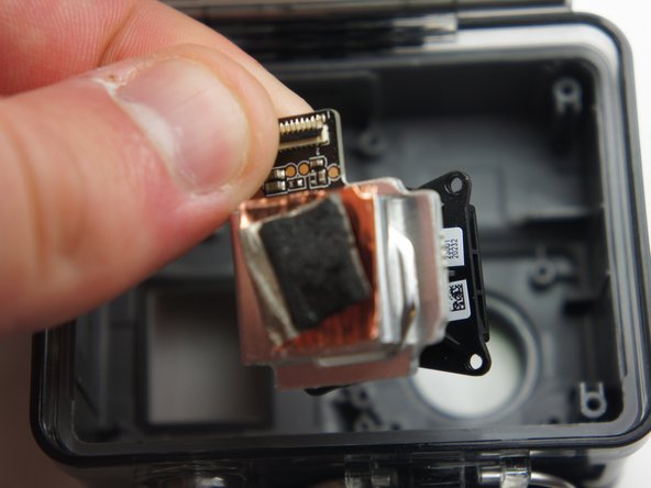

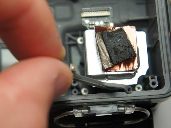

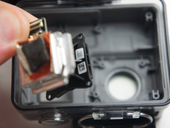

    1. GoPro Hero+ LCD Lens Replacement, Lens: crwdns2935265:016crwdnd2935265:01crwdnd2935265:03crwdne2935265:0 GoPro Hero+ LCD Lens Replacement, Lens: crwdns2935265:016crwdnd2935265:02crwdnd2935265:03crwdne2935265:0 GoPro Hero+ LCD Lens Replacement, Lens: crwdns2935265:016crwdnd2935265:03crwdnd2935265:03crwdne2935265:0
      • Remove the two 4 mm Phillips #000 screws securing the top button.
    2. GoPro Hero+ LCD Lens Replacement: crwdns2935265:017crwdnd2935265:01crwdnd2935265:02crwdne2935265:0 GoPro Hero+ LCD Lens Replacement: crwdns2935265:017crwdnd2935265:02crwdnd2935265:02crwdne2935265:0
      • Remove the four 4 mm Phillips #000 screws securing the lens to the case.
    3. GoPro Hero+ LCD Lens Replacement: crwdns2935265:018crwdnd2935265:01crwdnd2935265:03crwdne2935265:0 GoPro Hero+ LCD Lens Replacement: crwdns2935265:018crwdnd2935265:02crwdnd2935265:03crwdne2935265:0 GoPro Hero+ LCD Lens Replacement: crwdns2935265:018crwdnd2935265:03crwdnd2935265:03crwdne2935265:0
      • Gently lift the lens up and out of the device.
