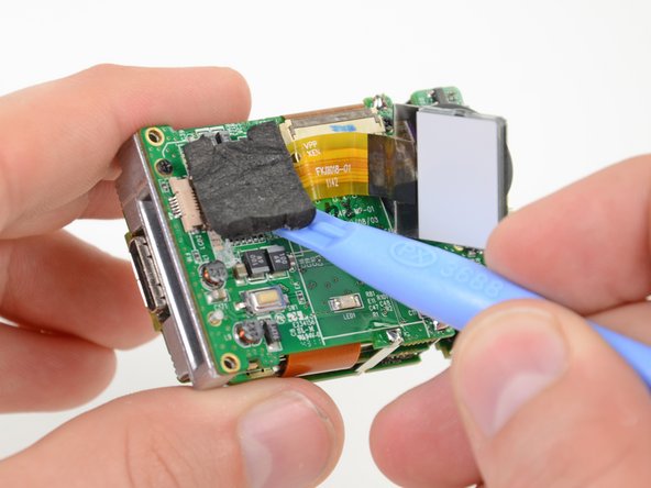

  11. GoPro HD Hero2 LCD Replacement, LCD: crwdns2935265:011crwdnd2935265:01crwdnd2935265:02crwdne2935265:0 GoPro HD Hero2 LCD Replacement, LCD: crwdns2935265:011crwdnd2935265:02crwdnd2935265:02crwdne2935265:0
    • Turn the motherboard assembly over to the side with the LCD and the camera lens.
    • Gently wedge a plastic opening tool underneath the foam padding on top of the LCD ribbon cable.
    • Pry the foam padding up until the LCD ribbon cable can be lifted off the surface of the motherboard.
    • Do not try to remove the LCD yet, as its ribbon cable is still connected to the motherboard via a ZIF connector.
