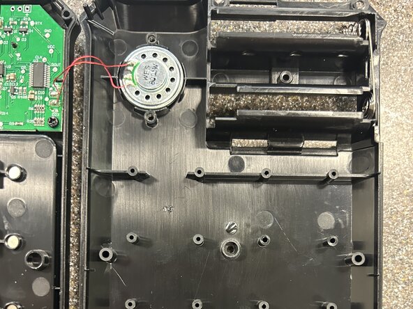

  9. Giiker Super Slide Teardown: crwdns2935265:09crwdnd2935265:01crwdnd2935265:02crwdne2935265:0 Giiker Super Slide Teardown: crwdns2935265:09crwdnd2935265:02crwdnd2935265:02crwdne2935265:0
    • Remove the two Phillips P1 screws holding down the speaker
  10. Giiker Super Slide Teardown: crwdns2935265:010crwdnd2935265:01crwdnd2935265:02crwdne2935265:0 Giiker Super Slide Teardown: crwdns2935265:010crwdnd2935265:02crwdnd2935265:02crwdne2935265:0
    • Carefully pull up the speaker out of its holder using one of the four notches to get a finger under and push or carefully prying with a spudger

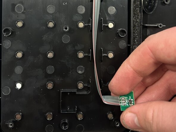

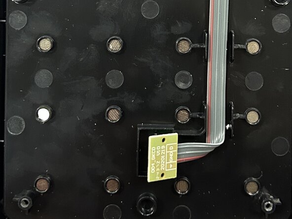

  11. Giiker Super Slide Teardown: crwdns2935265:011crwdnd2935265:01crwdnd2935265:03crwdne2935265:0 Giiker Super Slide Teardown: crwdns2935265:011crwdnd2935265:02crwdnd2935265:03crwdne2935265:0 Giiker Super Slide Teardown: crwdns2935265:011crwdnd2935265:03crwdnd2935265:03crwdne2935265:0
    • Lift up the main piece hall effect sensor
    • This does not adhere down well once removed, it is recommended to have some two sided tape to put under the sensor for reassembly

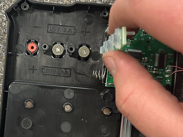

  14. Giiker Super Slide Teardown: crwdns2935265:014crwdnd2935265:01crwdnd2935265:03crwdne2935265:0 Giiker Super Slide Teardown: crwdns2935265:014crwdnd2935265:02crwdnd2935265:03crwdne2935265:0 Giiker Super Slide Teardown: crwdns2935265:014crwdnd2935265:03crwdnd2935265:03crwdne2935265:0
    • Remove the final two Phillips P1 screws holding down the main board
    • Pull up the main board carefully and set to the side
