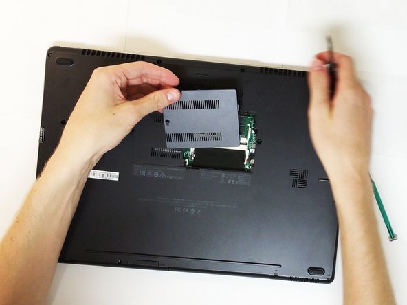

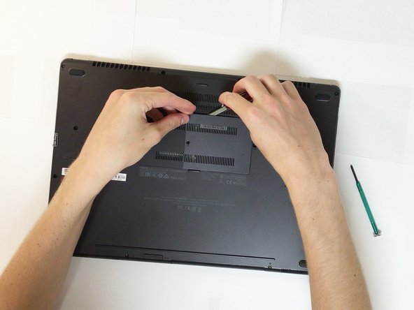

    • Locate the small plastic back plate.
    • Remove the small 4.0mm screw holding the small plastic back plate in place.
  3. Gigabyte P35K Laptop Hard Drive Replacement: crwdns2935265:03crwdnd2935265:01crwdnd2935265:03crwdne2935265:0 Gigabyte P35K Laptop Hard Drive Replacement: crwdns2935265:03crwdnd2935265:02crwdnd2935265:03crwdne2935265:0 Gigabyte P35K Laptop Hard Drive Replacement: crwdns2935265:03crwdnd2935265:03crwdnd2935265:03crwdne2935265:0
    • Remove the small plastic back plate.
    • Use a small flat head tool or knife to lift the plastic back plate and then use your hands to gently remove the plastic plate.

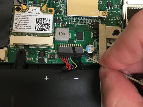

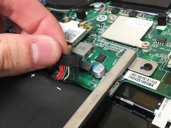

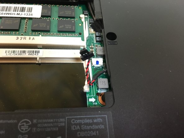

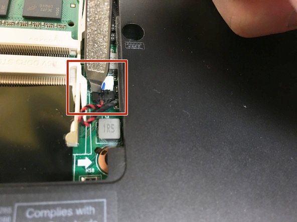

  4. Gigabyte P35K Laptop Hard Drive Replacement: crwdns2935265:04crwdnd2935265:01crwdnd2935265:03crwdne2935265:0 Gigabyte P35K Laptop Hard Drive Replacement: crwdns2935265:04crwdnd2935265:02crwdnd2935265:03crwdne2935265:0 Gigabyte P35K Laptop Hard Drive Replacement: crwdns2935265:04crwdnd2935265:03crwdnd2935265:03crwdne2935265:0
    • Disconnect the small red and black cord connecting motherboard to the case using a small flathead screwdriver.
    • This cord is located under the back panel which was removed in the previous step.
    • Do not pull directly on the wires, instead gently pry the connector apart.

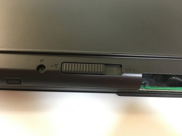

    • Slide the switch on the base of the laptop from locked to open.
