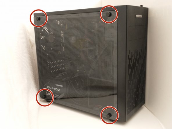

    • Place the computer on its right side and unclamp the left panel by turning the screws.
    • Remove the side panel.

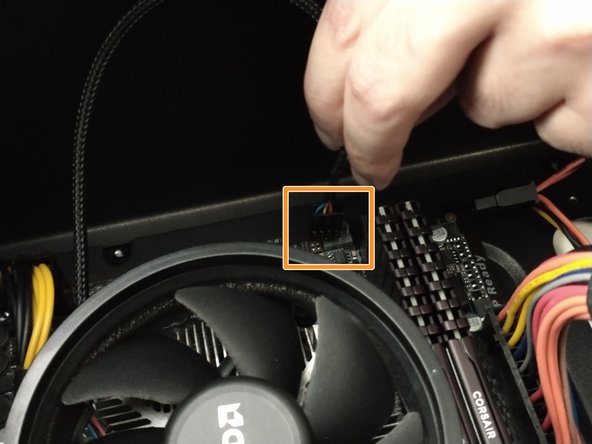

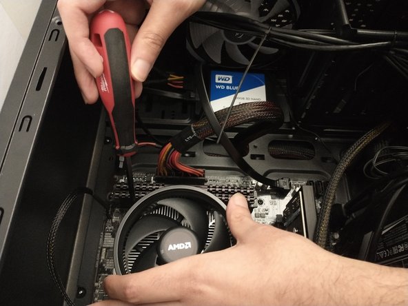

    • In order to access the CPU, the CPU cooler fan must be removed.
    • Using a Phillips #0 screwdriver, carefully remove the four screws located in each of the CPU cooler's four corners.

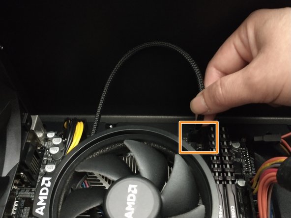

    • Disconnect the fan's power cable from the motherboard.
    • If you are having difficulty please refer to your motherboard's user manual for assistance.

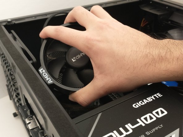

    • Gently lift and removed the CPU fan from the motherboard.

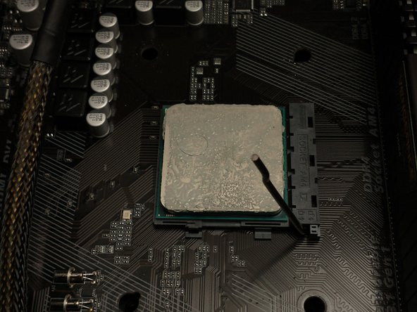

    • Be sure to clean off the portion of the underside of the fan that was in contact with the CPU off using isopropyl alcohol. This will remove any old thermal paste to ensure a clean connection during reinstallation.
    • You should now be able to fully see and access the CPU. If not, you may have done a step wrong and should revisit a previous step.
  4. Gigabyte A320M-S2H Processor Replacement: crwdns2935265:04crwdnd2935265:01crwdnd2935265:03crwdne2935265:0 Gigabyte A320M-S2H Processor Replacement: crwdns2935265:04crwdnd2935265:02crwdnd2935265:03crwdne2935265:0 Gigabyte A320M-S2H Processor Replacement: crwdns2935265:04crwdnd2935265:03crwdnd2935265:03crwdne2935265:0

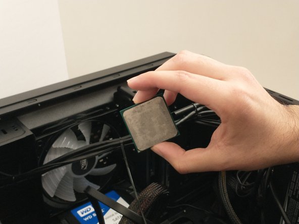

    • Lift the retention arm to unsecure the CPU.
    • Carefully remove the CPU from the socket.

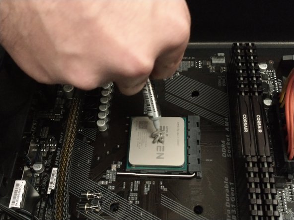

    • Find the right way to plug in the processor and gently place it in the slot.
    • Check to see if the processor fits tightly and is not tilted.
    • Lock the retention arm to secure the CPU.
    • Apply a small amount of thermal paste onto the new processor.
  6. Gigabyte A320M-S2H Processor Replacement: crwdns2935265:06crwdnd2935265:01crwdnd2935265:03crwdne2935265:0 Gigabyte A320M-S2H Processor Replacement: crwdns2935265:06crwdnd2935265:02crwdnd2935265:03crwdne2935265:0 Gigabyte A320M-S2H Processor Replacement: crwdns2935265:06crwdnd2935265:03crwdnd2935265:03crwdne2935265:0
    • Place the CPU cooler on top of the CPU and using a Phillips #0 screwdriver to tighten the four 10 mm screws in place.
    • Reconnect the fan connector to the motherboard.
